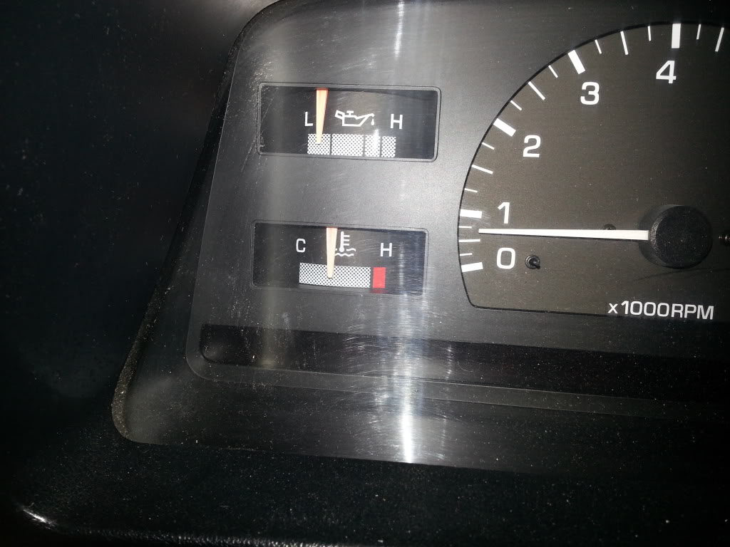

Is this how your temperature gauge reads after an hour of freeway driving?
This weekend I'm going to pressure test, replace the upper hose either way. Mine has a drip and I have one on hand. Then go from there.
