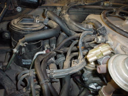

This rats nest of hoses and one or two of the tranny bolts is the worst part.
Attached Thumbnails 3.0 engine change is almost complete-cnv0780.jpg   3.0 engine change is almost complete-cnv0781.jpg
