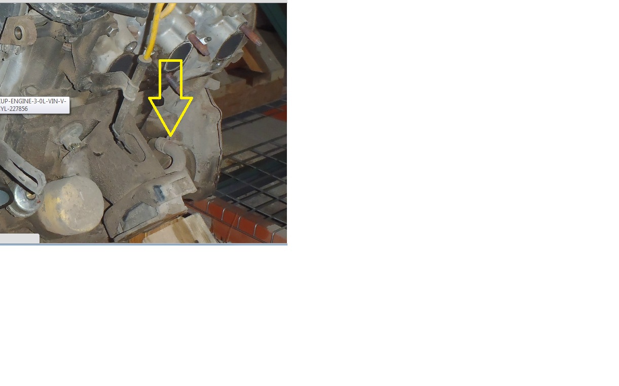

Please don't hate me for reviving this thread guys, I just want to say I appreciate all the information on the forum. I just bought a 3.0 1991 4Runner, and I'm feeling pretty crappy about the condition right now. This is one of the problems, leaking weird little hose. I'll get around to this, after I install a new starter.
Looking forward to being a part of this community.
Old Sep 17, 2013 | 09:27 AM
Gevo's Avatar
Joined: Sep 2013
Posts: 1,631
Likes: 110
Can anyone tell me if I am missing something here, why does it not show on the parts diagram? (the u-shaped hose in questions)

Just to make sure. This is the part we are all talking about....
(See attached)
Old Sep 17, 2013 | 11:12 AM
scope103's Avatar
Joined: Sep 2007
Posts: 8,381
Likes: 873
From: San Francisco East Bay
The coolant bypass hose (which started this thread) can be found:
http://www.toyotapartsoverstock.com/...rimLevel=18380
https://www.trdpartscenter.com/parts.../SR5/index.cfm
Gevo's picture is a different hose; could it be part of the oil cooler? Hard to tell with all that dirt! http://www.toyotapartsoverstock.com/...rimLevel=18380

Scope 103, I believe you may correct. If I remember correctly it was connected to that "Cooler Assy, Oil " gizmo. I will double check when I get home. It had a pin hole leak spraying coolant on to the exhaust pipe and steaming.
I'm generally pretty good with cars, but I don't have experience with oil coolers. The hose in question, although for the oil cooler, would still be carrying coolant and not oil, correct?

Old Sep 17, 2013 | 11:36 AM
TNyota's Avatar
Joined: Aug 2013
Posts: 24
From: Tennessee
The one in the pic is the oil cooler coolant hose, I think the one we are talking about is between the firewall and intake plenum, little upside down U going from coolant bypass to the little coolant manifold block back there.

OK, great, thanks for the confirmation. After seeing the oil coolant assembly I was pretty sure that's my hose.
Step 1, check. Step 2, find replacement
