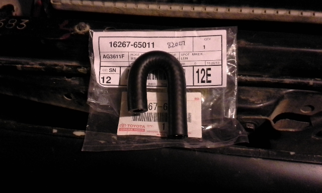

Reviving this thread again.˟ Just went through replacing this hose.˟ Tried to use the dayco hose listed, but the inside diameter is too large.˟ Ended up ordering from the dealer, came in the next day.
Here is the part #, cost $14
Also, if you take the hood off, you can get to this hose with some long handled needle nose pliers.
