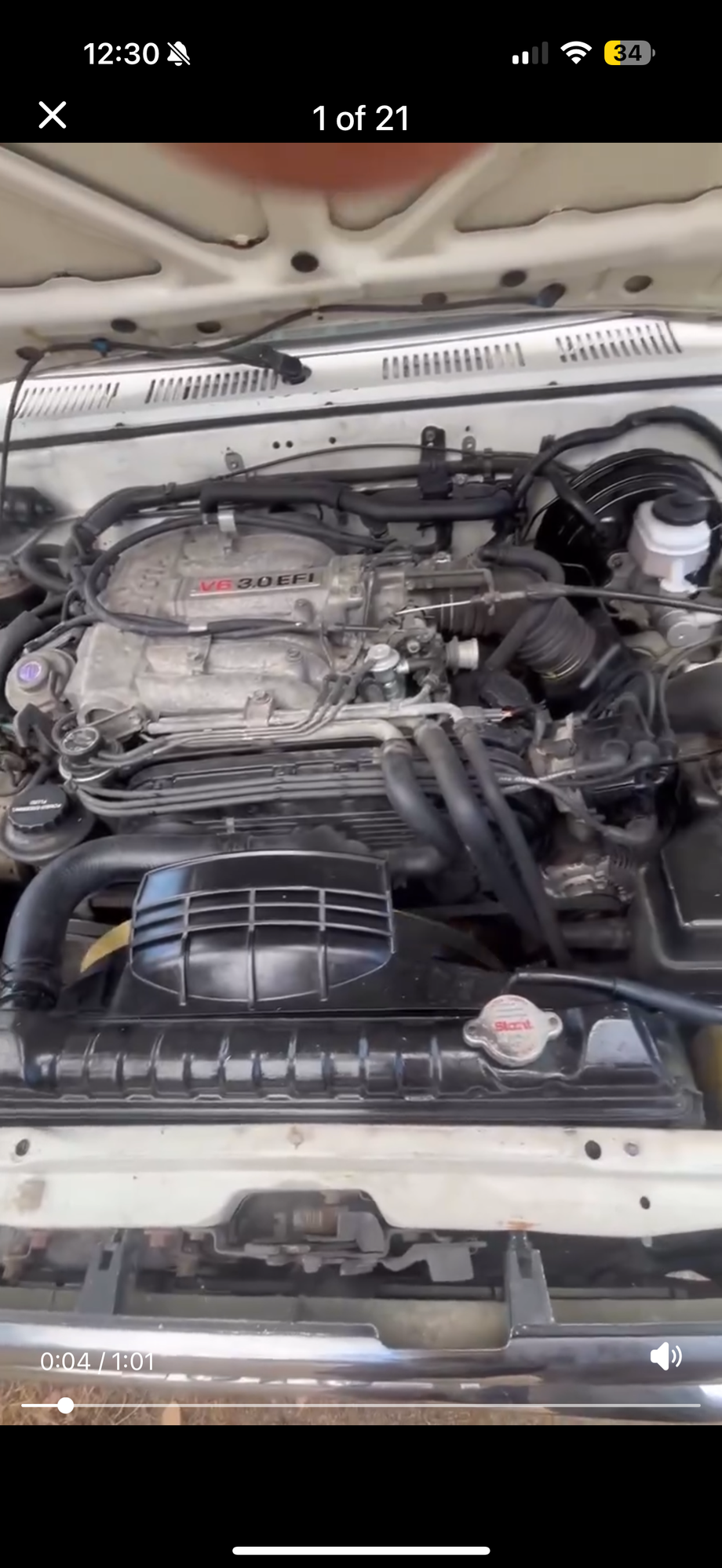

Newbie here. I am going to take a look at a 1989 Toyota Americana motorhome with 84k original miles. I've been doing my research and I am aware of the head gasket issues. I tried searching online if the work has been done no luck and toyota says they don't have anything on record or show any open campaigns/recalls. I would really appreciate any help. Thank you!
