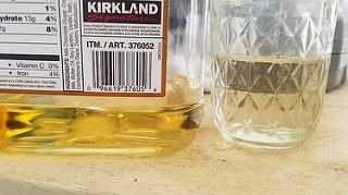

So I sucked some gas out of the tank in the big jar the small jar is fresh gas. The old gas smells less potent but still smells like gas. Im thinking its bad although I dont really know what gas should like. haha
