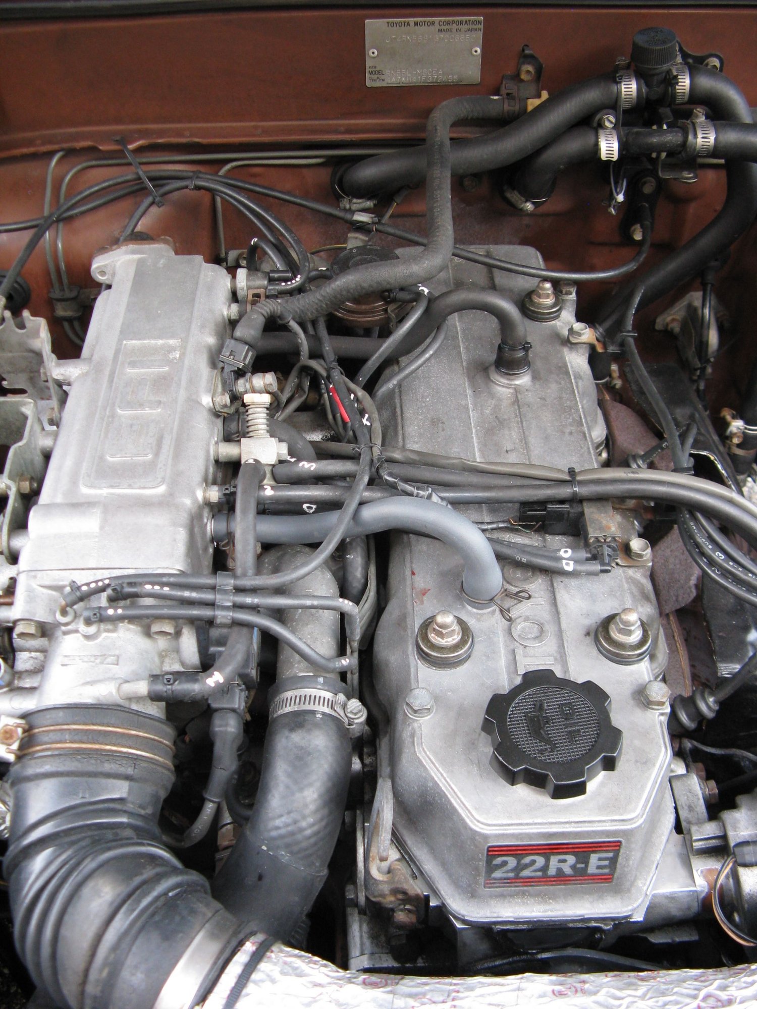

Does anyone know where this wire goes in the engine bay? It was tucked under the intake manifold and I'm not sure if this is supposed to be plugged in somewhere or it's for something that my car doesn't have? 1986 22re all stock.

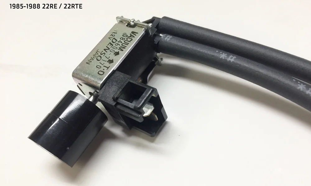

My guess is it goes to the AC idle Up VSV that is usually mounted to that right side front bolt on the valve cover. Don't see a VSV in the pictures.
Does your truck have AC?
In this video you can see the plug is square on this truck. Seen other shapes too.

I don't see the Idle Air Control valve that attaches to the intake manifold. Looks like there is a plug.
Nor the VSV mentioned above that connects by vacuum lines to the Idle Air Control Valve.
On this VSV you can see the plug looks like it matches the one on that wire.
You can see both on my 86 22RE w/factory AC

Interesting... I definitely don't have that part and the AC is there and works just fine.
