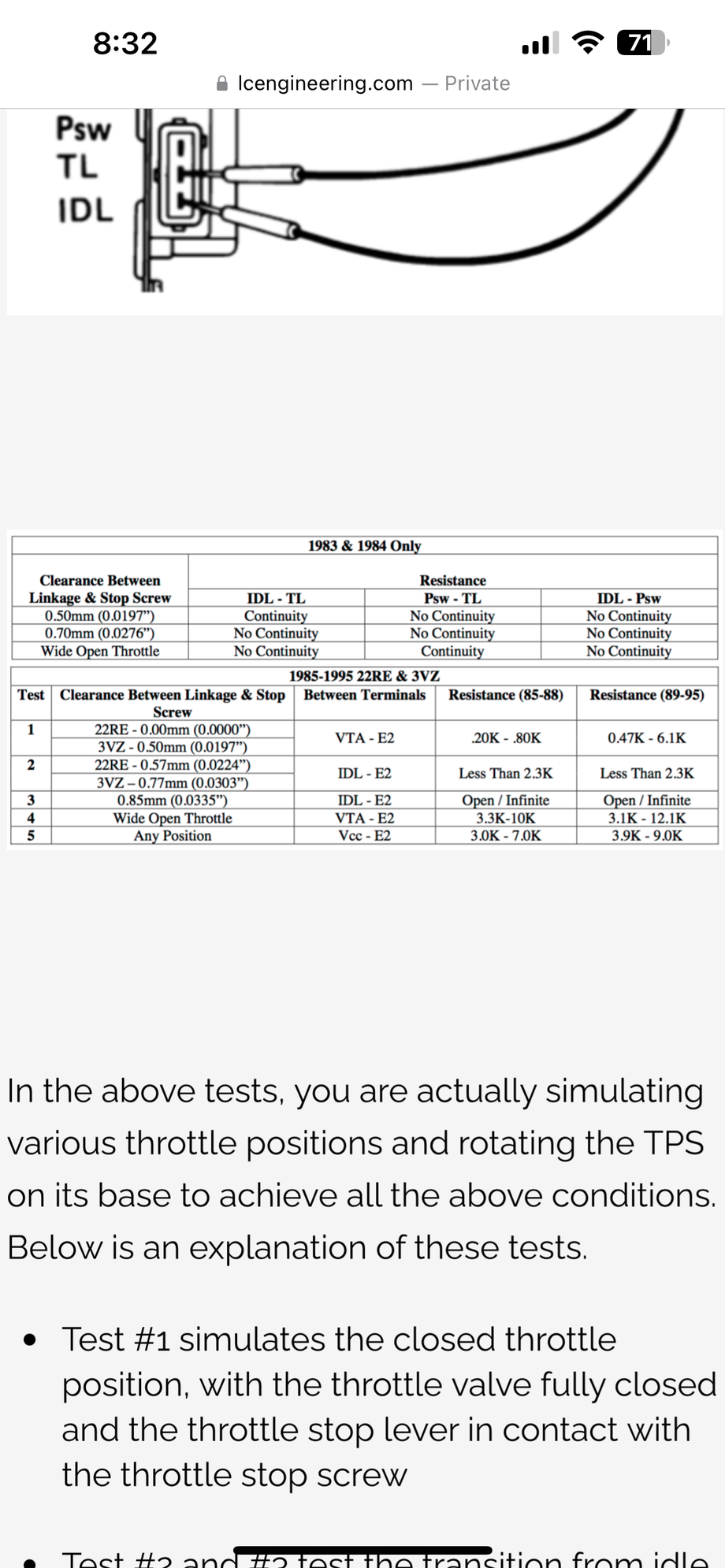

Ive been chasing this IDLE surging for a while since November 2021. When summer comes I adjusted my idle screw for the surge goes away. When winter comes I Have to re-Adjust my idle screw for the surge to go away. I have finally permanently solved the surging issue. I
recently replaced my throttle position sensor and adjusted it properly using LCE adjustment procedures. the truck has never ran or idle so smooth since Ive own it. Hope this helps someone else with the same problem.

The LCE procedure differs from the FSM? If so, can you copy & paste the LCE procedure? Thanks
Old Oct 16, 2023 | 07:33 PM
Awaters54's Avatar
Joined: Dec 2021
Posts: 10
https://lcengineering.com/part-1061042-1061043-1061044-1061045-1061046-1063034-1061039-throttle-position-adjustment-procedure/
