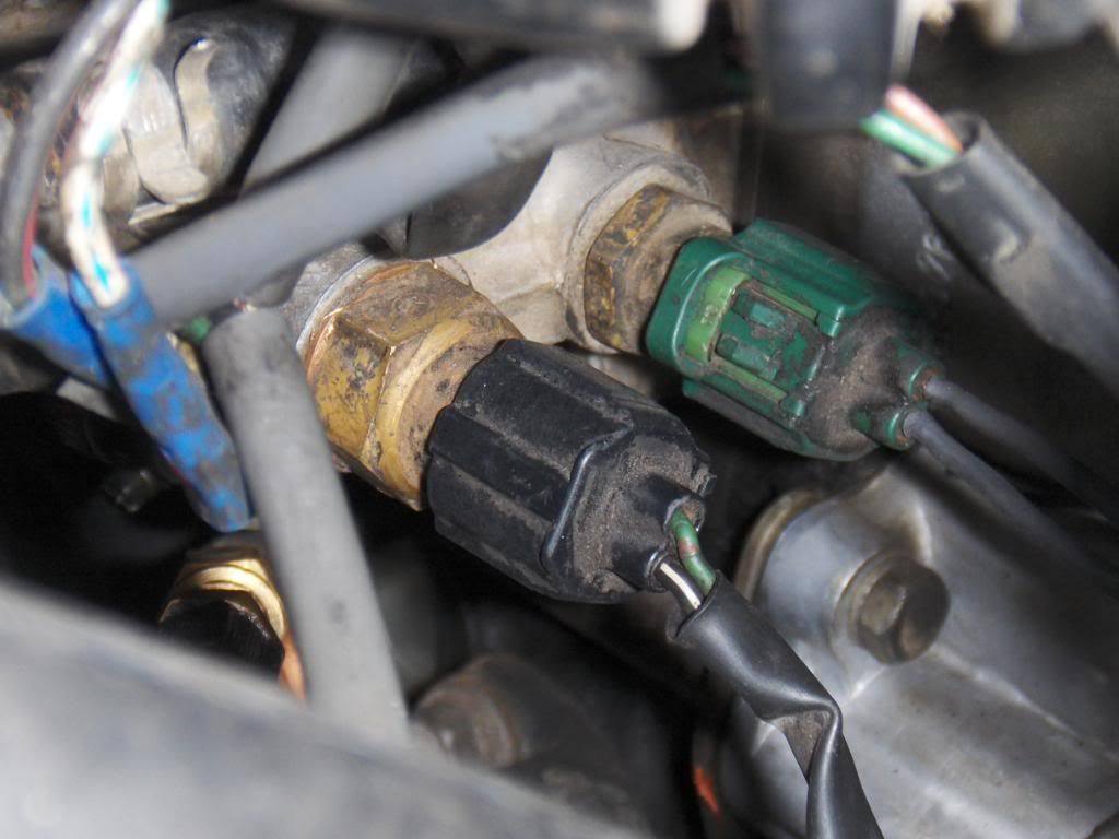

Sounds like one of the water temp sensors- one feeds the cold start injector and one the computer.
My guess and place to start looking is the cold start injector time switch. It's not turning off as the engine warms up and dumping in more fuel than needed in the process.
Cold start injector time switch on the left (black) and coolant temp sensor on the right (green)
Could be just bad connection.
Try disconnecting it when the problem occurs to see it that stops it.

Thanks JoeS. I also thought it was temperature related and possibly something to do with the cold start injector but I don’t know the makeup of the system. (Now I do). I unplugged both connectors(they look fine, wiring too) reconnected and ran it this morning. After it ran for awhile, I unplugged the cold start injector sensor and it seemed to run fine when I gave it throttle. I’m going to check the resistance of the sensor tomorrow morning.
The problem has been so inconsistent that it’s hard to know if what I did helped.
We’ll see. Thanks for the ideas. I will keep you posted.

sounds ok, except that the CSI only operates when the temp is below a certain threshold AND the key is in the "start" position. the CSI does not inject fuel into the upper plenum when the key is in the "on" (run) position. as soon as the key is released from "start", the CSI stops injecting (spraying) fuel.
