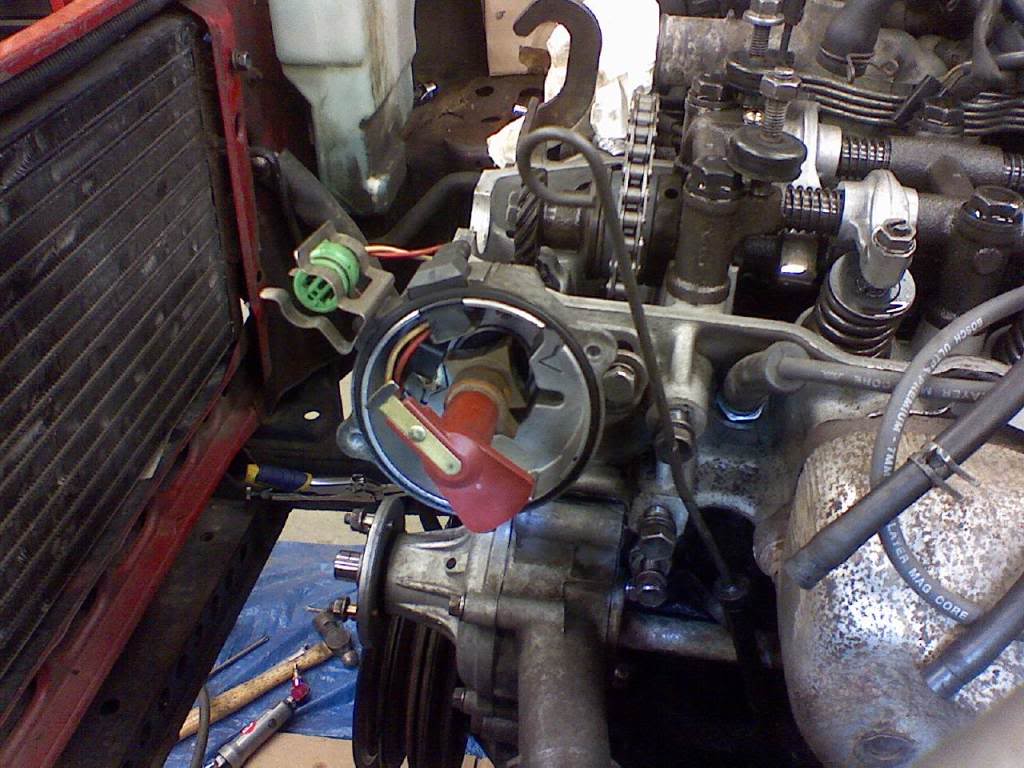

I just rotated the motor around 8 times and all is lined up. 2 cycles around I guess.
So much for following the instructions and lining up the timing marks on the cam gear.
Thanks for setting me straight. SO much for not being a newb to Yota's
0 degress
12:00
perfect 10:00

thats perfect...
be sure to report back on how she runs....

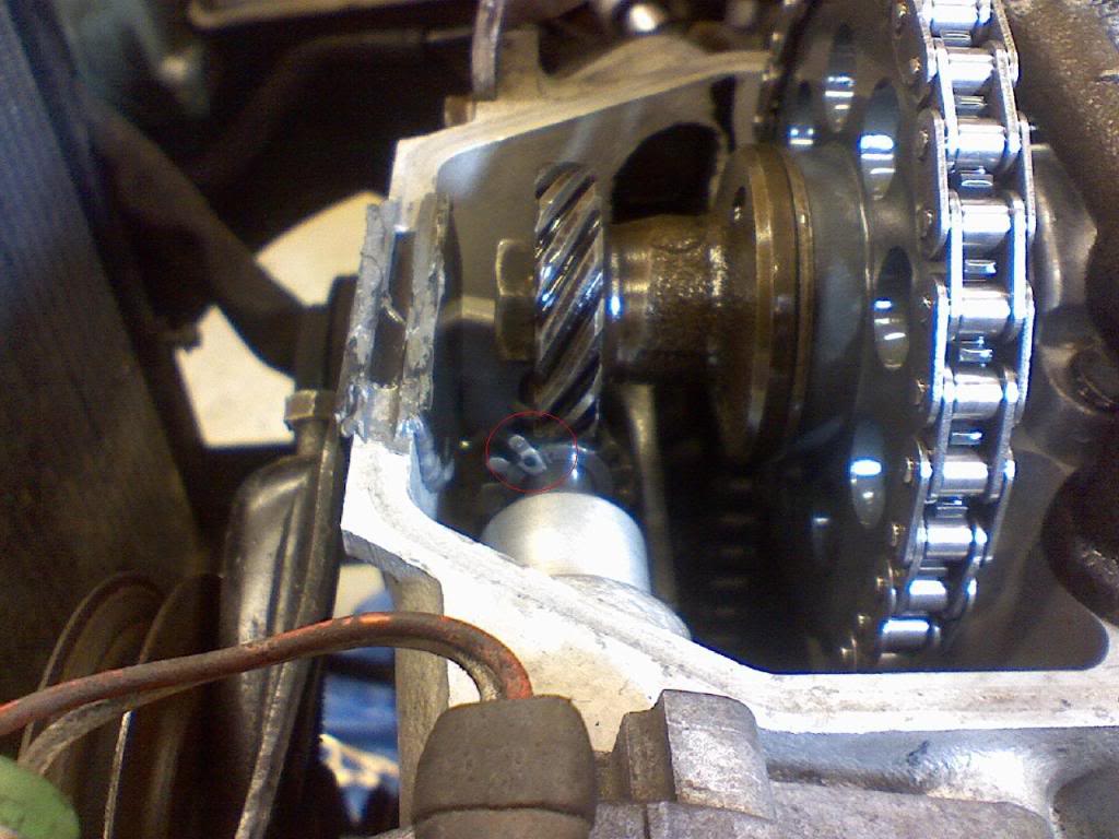

so I finally got it fired up. Purred like a kitten, but the timing mark is still showing way retarded and I was unable to draw it in with the distributor. That leads me to believe that there is something else at play here. In the last picture I posted you can see that the #1 point on the rotor is lined up with the pickup, yet the motor is set at 5* BTDC. Should that be the case, or should the rotor shoe to be 5* advanced or advanced at all there?
I noticed that the distributor shaft has a mark on it that looks as if it should be lined up with the dist gear on the cam. Should it be? Here is a picture of what I am talking about. Faintly circled in Red.

Before sleeving the crank, try a front main seal from an early 22R motor. They sit on a slightly different spot.
As for the distributor, just check the running timing, and adjust accordingly. If it's running, no need to mess with static timing any more.

as for the timing, you have to short the te1 and e1 terminals in the diagnostic plug (also, the TPS has to signal IDL (idle position) to the ECU) in order to set the timing. If you're doing that, then maybe you need to pull the distributor out just enough so that you can rotate the rotor a bit so that you engage the next tooth on the gears.
But 5BTDC is where it's supposed to be at, with the jumper in place. 5BTDC means the timing is 'advanced' 5 degrees with respect to the crankshaft position.
If you have the diagnostic plug jumpered, the mark on the crankshaft should be illuminated when the plug fires, and the mark should be at the 5 mark to the left of 0.
