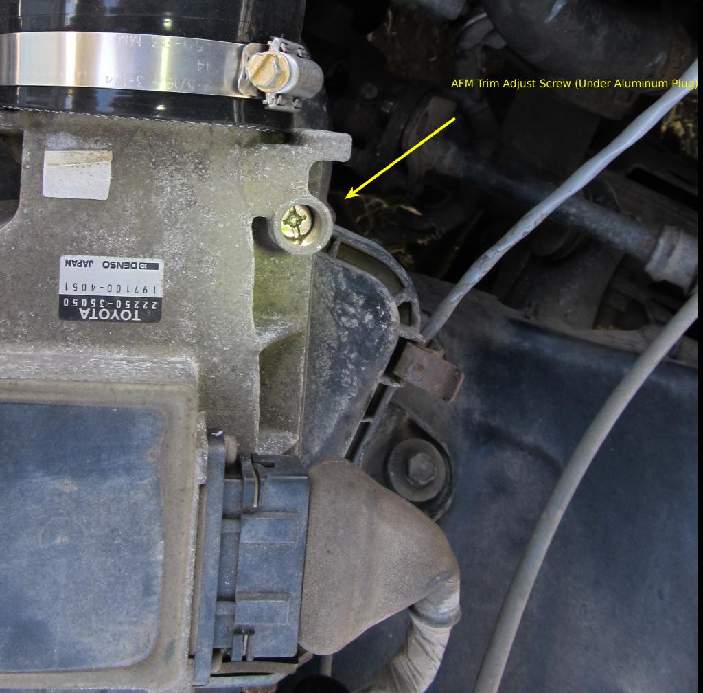

There is a trim screw on the AFM that will smooth out the idle. It's factory sealed with an aluminum plug. If all else checks out ok, pull the plug out and adjust for smooth idle. We usually didn't unseal them until after 60k miles, after that it's almost required to get back a smooth idle.
My odometer is sitting at 160,000 but judging from the condition of the truck it could have more or someone used it for a construction site vehicle.
Plug? I take it you're talking about enriching the idle fuel mixture highlighted in red?
Information taken from the following link http://www.celicas.org/mods/afm.html

No, that's the wrong way and only screws up the entire A/F ratio. It's under an aluminum plug on the top. Drill a small hole in the plug being careful not to drill too deep or you'll bury the adjust screw under it. Put a screw in the hole, wiggle out with pliers. Adjust a little at a time, more than 1 turn you have other problems. After adjustment, Put old plug or other cap in to prevent water or dirt getting in. Here's a photo showing plug removed on my truck... Name:  AFM_zps5815e3c8.jpg
Size:  125.3 KB This trick works on more than Toyotas. Edit: Yes the text in RED. Re-clocking the gear or modifying the electronics is the wrong way. The reason they sealed it was for smog, they didn't want amateurs messing with it.

Gotcha, thanks for the pic
