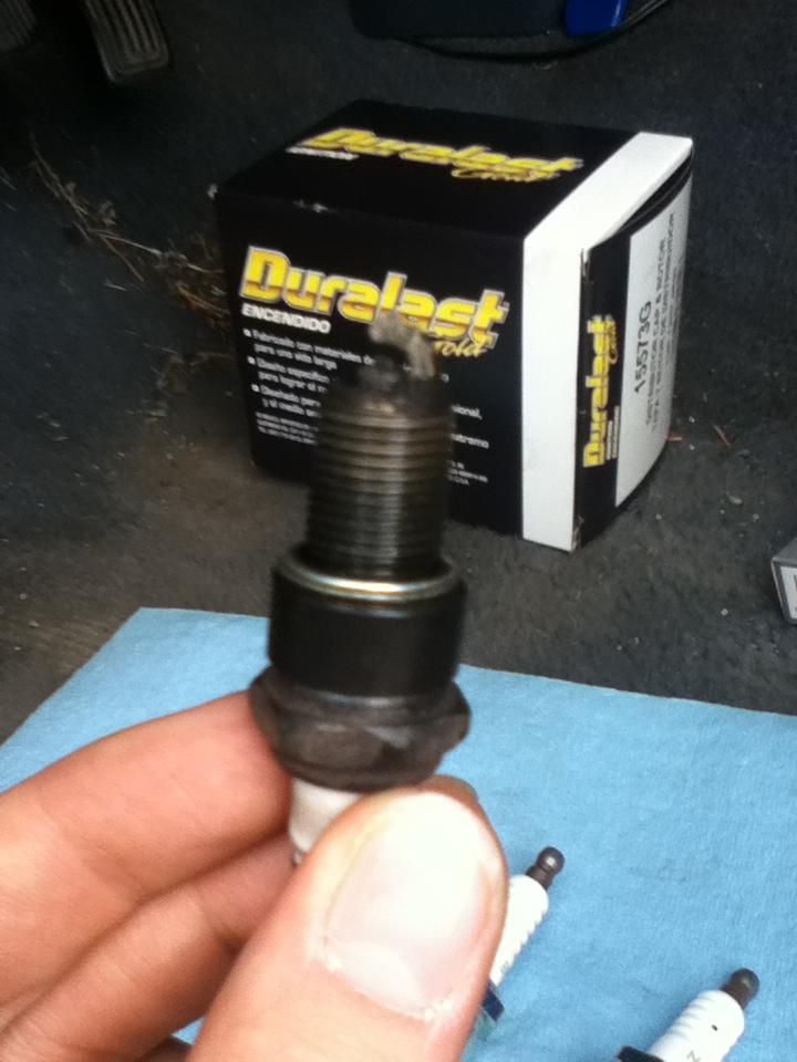

Hey guys! After a quick trip to AutoZone today I went ahead and grabbed new plugs, wires, and cap & rotor and after everything went in and I started her up, she purrs again like a kitten! I can't believe the difference from when I started to now! Here's some of the things I picked up and some pictures!
sorry for the low picture quality!

Gnarly buildup on plugs 3 & 4

Thanks again for all the help guys! This forum is a life saver!
