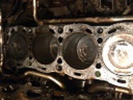

with the oil burning pcv problem has anyone looked at their pistons i have a build up and i think its from oil. was thinking the rings didnt seat but now leaning towards this as there is oil residue in the intake manifold.22re oil getting into intake after rebuild?-22re-block.jpg
