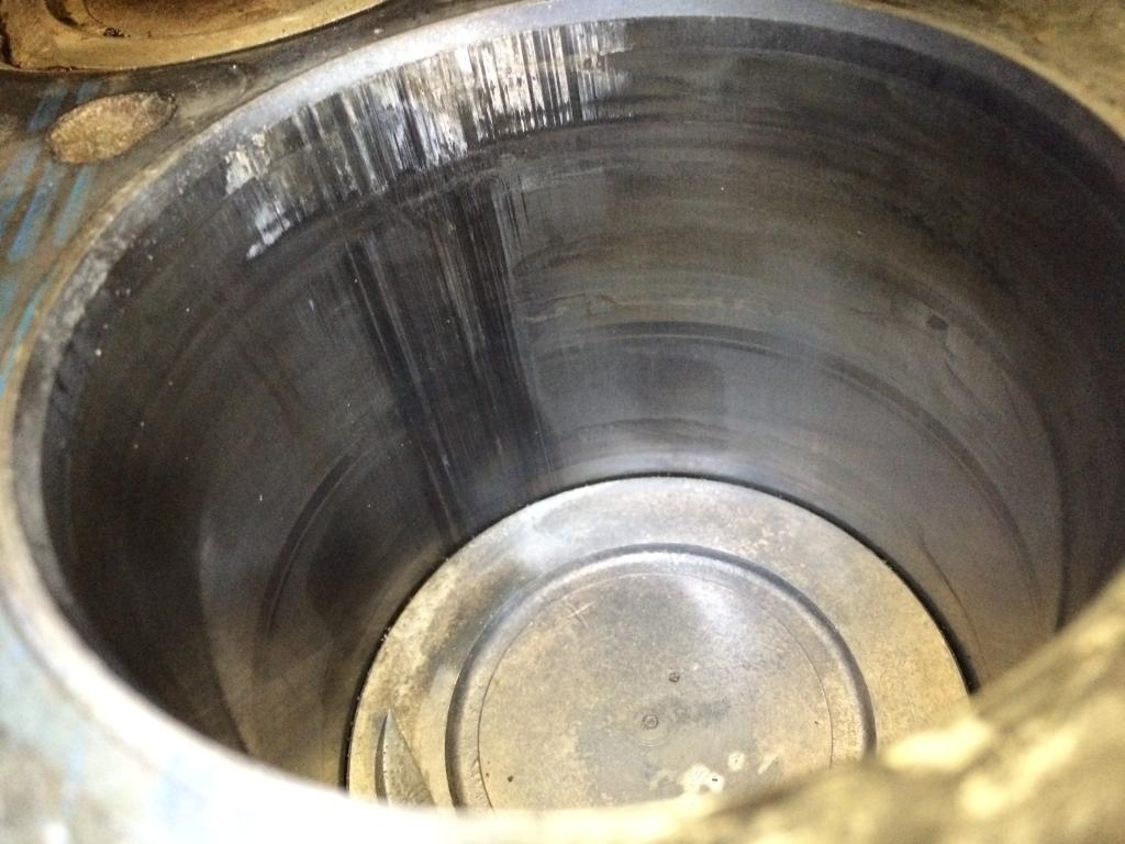

Alright I got the head off and have started cleaning it. There is a decent amount of scoring in two of the cylinders I attached a couple of pics. So i need to rebuild bottom end and get the cylinders honed right? I am cleaning the block and head to see if anything is warped. What else should I look for..

It looks as if you are going to need to bore it now with those scores. Your cost just went up quite a bit as you need to pay for a bore and new pistons. Ask a few of your part store clerks which machine shop they would recommend, they will usually know. Finding a good shop will tell you what all is needed to be done.
Looking at the head will not necessarily tell you the head is warped. You can try using a straight edge to see but you are dealing with thousandths of an inch. You will need a machine shop to check it. I had a head that I thought was cracked and it was carbon. Had another I thought was carbon and it was a hair line crack. Literally a hair line crack is the size of a hair and can be easily over looked.
Is there any scoring on the bearings on your rod caps? Some other signs I would be looking for to see if any bottom damage. That will give you an idea if you are going to need some machine work on the crankshaft. Visual checks just give you an idea of what is going to need to work. To see how far things are out, you need micrometers and other specialty tools.
