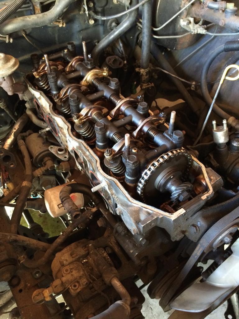

Hey hows it going guys I just bought a 1988 Pickup with a 22re in it. I bought it for cheap. It does not run its getting fuel and spark with low compression sounds weak when you turn it over. There was hardly any coolant in the radiator and P/O said it was over heated. So what am I looking for when I pull the motor apart.. Warped head, pistons, bent valves? What would you suspect i guess is what im saying.
Ive gotten most of the motor apart but stopped cause im at my parents house for the weekend. From where im at whats the best way to get the rest of the head off? Timing chain and tensioners look good so im gonna leave it for now. do I just pull the distributor drive nut off and then head bolts or what? Do I need to be at TDC for cy1? how do i line that up
Thanks guys from what ive read this is a very helpful forum. Im very excited about my new purchase (as soon as i get it running its getting a paint job)

Pull the motor completely out. The take the head and block in for testing. Don't get the head milled. If it's warped just buy a new one from engnbldr. About the same price as a test deck and flush. Might not even test your current one if it over heated. Take the block and timing chain cover in at the same time and get them decked of needed. Not more than 10 thousandths at the most. Should only need like 4-5 thousandths. We hope. Then get your crank inspected. Maybe have the cylinders bored. Order a rebuild kit from engnbldr. And start wrenching. Also get new head bolts every time you do a head gasket. Just cheap piece of mind

I agree with the fish guy parts are cheap and you'll regret doing half the job to find out you should have done it right the first time.

You can do the head with it in the engine bay but your back will thank you if you pull the motor. I have the Factory Service Manual and a Haynes Manual. I have compared both of them for a top end rebuild and they are the same. FSM is a little better for a complete overhaul but not by much in my opinion. The quick and easiest is to get a Haynes for about $20 and I suggest staying away from Chilton Manual.
While you still can, I would get a tool setup and use the starter to break the crankshaft bolt loose. If you are going to at least do the head, do the Timing Chain as well and you need the crankshaft pulley off for that. If you pull the motor then you can get an impact wrench to break the crankshaft bolt loose. It is tight!!!
A top rebuild isn't as quick as you may think. Being a two wheel I just pull the tranny with the motor. Easier to connect the tranny, just how I do it.

Thanks for the responses!! So basiclly even if I find a warped head and replace it there is more then likely going to be more damage in the bottom end?
I completely agree I have it torn down this far why not run through the rest of the motor. But I don't want to do more work then necessary you know.
One more question i have read alot about getting the crankshaft bolt off with the starter but how about reinstalling it how do you effectively torque it back down?
Thanks, Andrew

So I took the timing chain off, the power steering pump/bracket, 8 head bolts and the little bold on the front of the head. And the head is stuck on there
Are there any bolts or brackets on the back of the head that I am missing. I wedged a flat head in between the gasket in the front and got a little wiggle but i dot want to damage the block.
Any suggestions???

I think you missed 3 bolts. rocker arms should come off as an assembly. Little but long bolt under cam gear into front cover.
Rap with a dead blow hammer, maybe just be obstinate.
