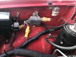

Look at the picture below. Do you have that electrical component mounted on your right inner fender(resistor for injectors), and is it connected? If the answer is yes, and you're sure you have 1989 injectors, than you have a bit of a mish-mash to sort through. 1989 injectors didn't use that resistor.
I still strongly suggest getting a 1987 EWD manual off ebay or wherever. You'll need to decide which style EFI you want to have. My thought would be get 1987 injectors and call it a day. Just depends what parts you have installed, or what the PO gave you in a box.

Yeah basically I have the resistor pack but its only connected to one of the plugs from what I recall. the other one doesn't exist as there's no plug on the 89 harness for resistor pack. I think it also goes to something else.
