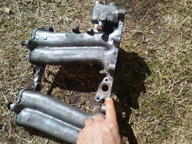

It bolts to the bottom of the intake with two 10mm screws and can be a royal pain to access. It has a bolt to back of the head with one (12mm I think?) and I have to access it from the passenger side and really stretch. You cant see it, just have to feel for it.
It has a rubber seal and is right below the water temp sensor. I access it from the front, working above the ac compressor.

I just put this all together. Yep two 10mm screws under the intake and one 12mm on the back of the head. I remove the passanger front tire and access panel in the wheel well to get to this. I also dab a bit of silicone on the O-ring and stick it up top in the manifold. I had a past experience just putting the O-ring on the pipe and bolting it in were the ring didn't seat properly in the manifold and it would leak. The bolt on the back of the head is on the drivers side at the bottom of that "EGR" plate. It's a pain for sure. I used a ratchet wrench and sacrificed a goat to deal with it.
