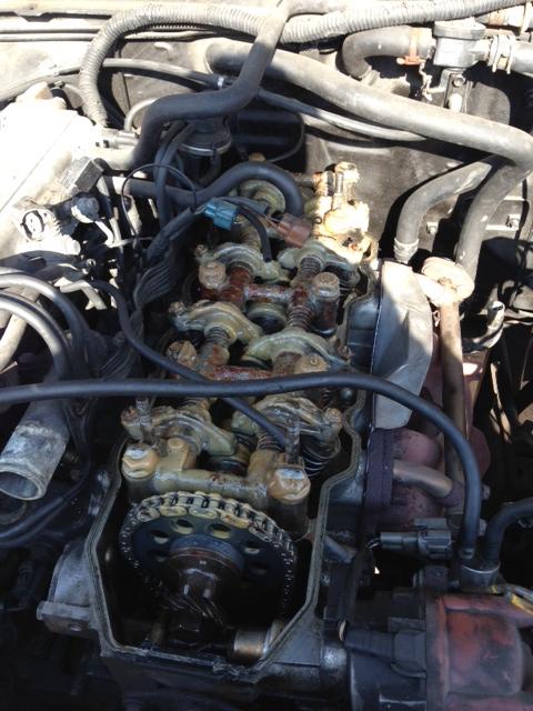

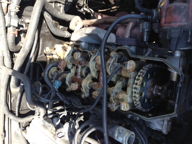

Finally had some time to dig into this. Ordered OEM head gasket, new thermostat and waterpump. Pulled the valve cover and this is what it looked like. I not going to bother fixing this the way it looks. time for a new engine or to get rid of the truck unfortunately. also, the driver's side guide looks like its gone so I'm not even sure if it was the headgasket.
