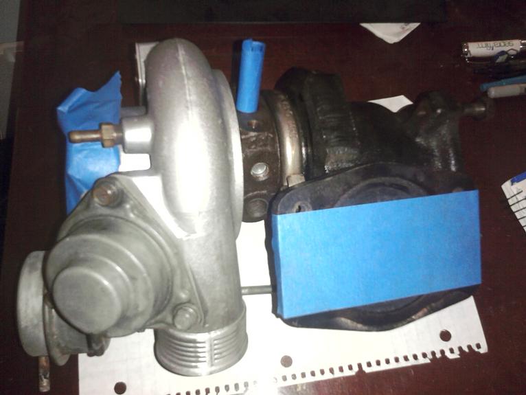

This is the contraption I wish to put next to the head of my 22re...

uhh..that doesn't look like it'd bolt up to the head of my 22R (same head as 22RE)
the bolt holes on the bottom closest to the inside are too low i believe.
mine are level all the way across

Yea I see what you are saying. Some of the dimensions look a little funny.....and I am sure it was designed with metric measurements from toyota so the drawing dims may be off some.

Nevermind...it's right...I will have to register on pirate to thank the guy.
