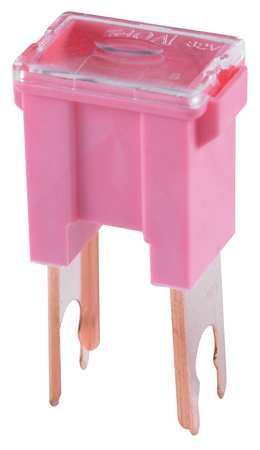

You said you checked "all" the fuses, but did you check the 30-amp AM2 fuse? The fuse boxes change subtly year-to-year, but a 30-amp fuse looks like this:
I've never removed one, but I am told (here) that they are bolted in; don't try to just pull on them.
Yes, the part of the fuse block they are in is removable. It's how you get to the big "fuses", or, as Toyota calls them, fusible links. It's also where the fusible link from the battery, and the one from the alternator, enter the fuse block. The overly fat, white wires.
It's been a while since I pulled it, but IIRC, it has a bolt, or two, that connect it to the side of the truck, and a single 'press to release' catch. You can easily see it when you look down at that part of the fuse block. The two nuts are 10 MM, and you pull them, release the catch, and that part of the fuse block lifts up and out far eenough to flip it on it's side, and get to all the connections on the underside.
While you have it out, make sure you check for corrosion. That stuff is insidious, and can cause all kinds of odd problems. Check the ground connections in the engine compartment while you're there. You might be surprized.

You may be able to tell if the fuse is open by looking through the clear top. But you could easily have a more subtle issue, which you will deftly solve by tracing with your multimeter. I suspect that removing the under-hood fuse-block is in your future.
