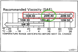

Originally Posted by shafner30
doesn’t get cold enough down here in California in the bay area
Much less here in So Cal
I've been using 10W-30 because it's less expensive at Wal-mart, but I'm gonna shop for 15W-40 or 20W-40
Attached Thumbnails 22re   Cold start up / thermostat ?-screen-shot-2017-12-04-10.19.23-pm.png

lol cool never seen 20/40 oil but walmart have killer pricing on Castrol gtx 20/50 it’s like $17 for a 5 qt jug
