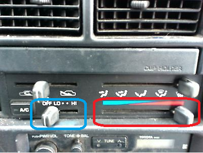

so have a ? for u guys
when the truck is warming up from dead cold motor with the heater on why does the temperature go over past half way mark close to the red on temperature gage? and when the heater is off the truck warms up to the Proper spot on temperature gage and dies not go past the normal spot on
Temperature gage
its a 1990 22re 2wd

EDIT: We need come clarification on the original question.
When you mean you turn on the heater and the coolant temperature gauge approaches the red zone, do you mean that you are turning the blower motor on OR that you are moving the HVAC temperature control knob to full hot? I other words, does the temperature gauge react to the blower motor being turned on and off (Blue box) OR from moving the HVAC "cool-hot" slider from full hot to full cool (red box)?
This will help us determine if you have an electrical issue or a mechanical issue.

Originally Posted by old87yota
...does the temperature gauge react to the ONLY blower motor being turned on and off (Blue box) OR from moving ONLY the HVAC "cool-hot" slider from full hot to full cool (red box)?
Yes, This^^^.
