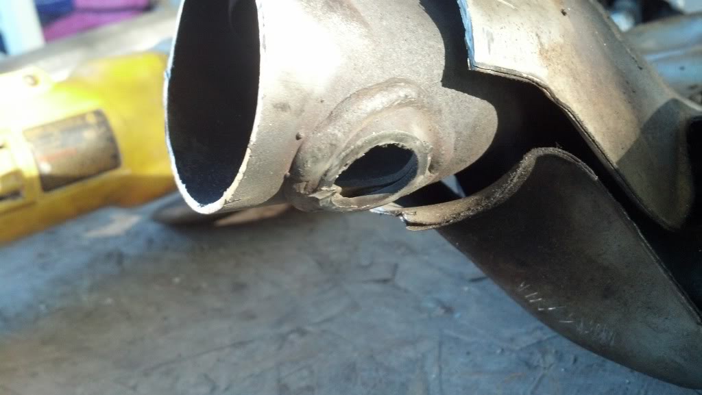

here is the ls manifolds cut and cleaned up for welding. i cut off the flange for the egr i will be welding a patch panel over it.
i haven't decided on my coupling devices be it flange or slip fitting, im more leaning toward the slip fitting i already have.
