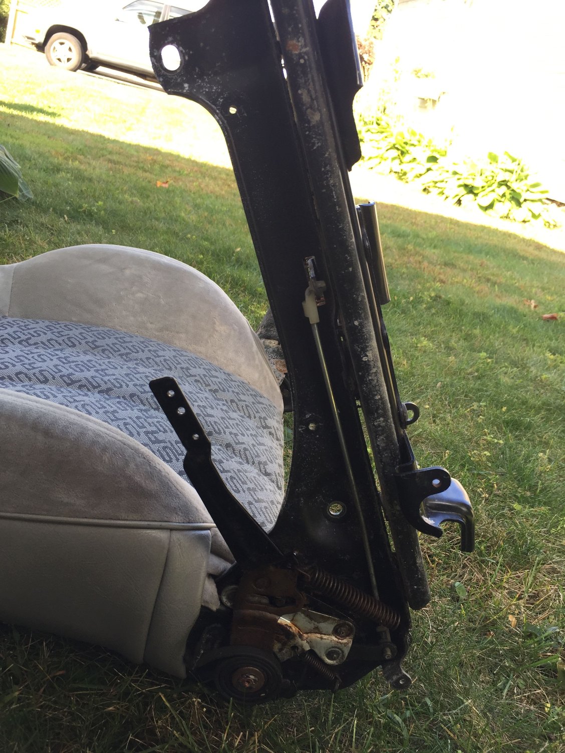

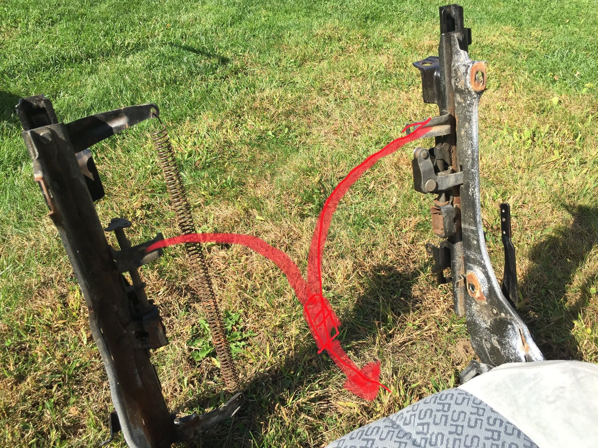

I have an SR5 seat apart at the moment so i shot a few photos and marked up where the cable goes(not sure which side in the rear it runs to looking at the photos in retrospect). Hope this helps.

Hah. Well glad it sounds doable at least. It makes sense now, I guess when it folds forward, it tightens the cable and those hinges release, sliding forward. I’ve got to fix that, and replace the springs/wire rods. But at least the drivers side works!
Thanks for for the pic! Even though I have my seat out and have stared it down, that simplifies it. Are you rebuilding the entire seat?
I got this set of Sr5 seats about ready to go in. I had the seat apart to swap the bases between driver’s seat and passenger.

If you don't have the cable housing, which is a special Y configuration, I think you can still buy the part new or get it off ebay sellers but you need that housing for it to work.
