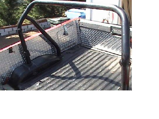

I have done this diamond plate conversion for the 1st gen runner. I did 1 solid piece from the front seatbelt line to the back corner and have the access doors with pad locks so i can put stuff in and lock it when the tops off... let me know what you guys think.

Those panels look good , Nice work man!!!

thanks RMA, This was the first one i have done, and i think i could get another done in a couple of hours but i do have a few things i would change...Like hank said, a rubber edge cover would be benifical for sound proofing, as when your driving there is a liitle rattle, mostly from the doors, but i opted for a thick window weather stripping. also a nice bead of caulking on the bottom edge near the floor helps a bit with rattles, then the linex over that and im 99% rattle free. let me know if anyone has any questions, sorry there isnt a write up for it, as i did the panels before i found y/t
