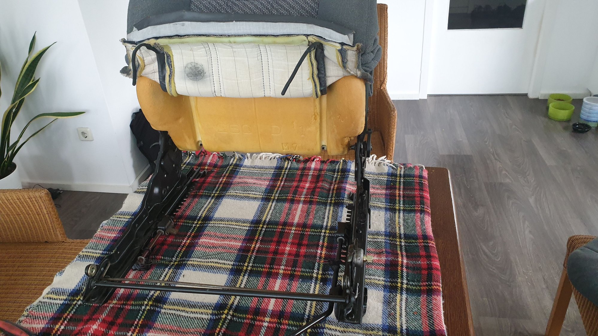

How bad is the deteriorated part? Do you need to repair the bottom and the back of the drivers' seat?
The seat bottoms can be swapped left and right, the frame's different.
Pics for reference:

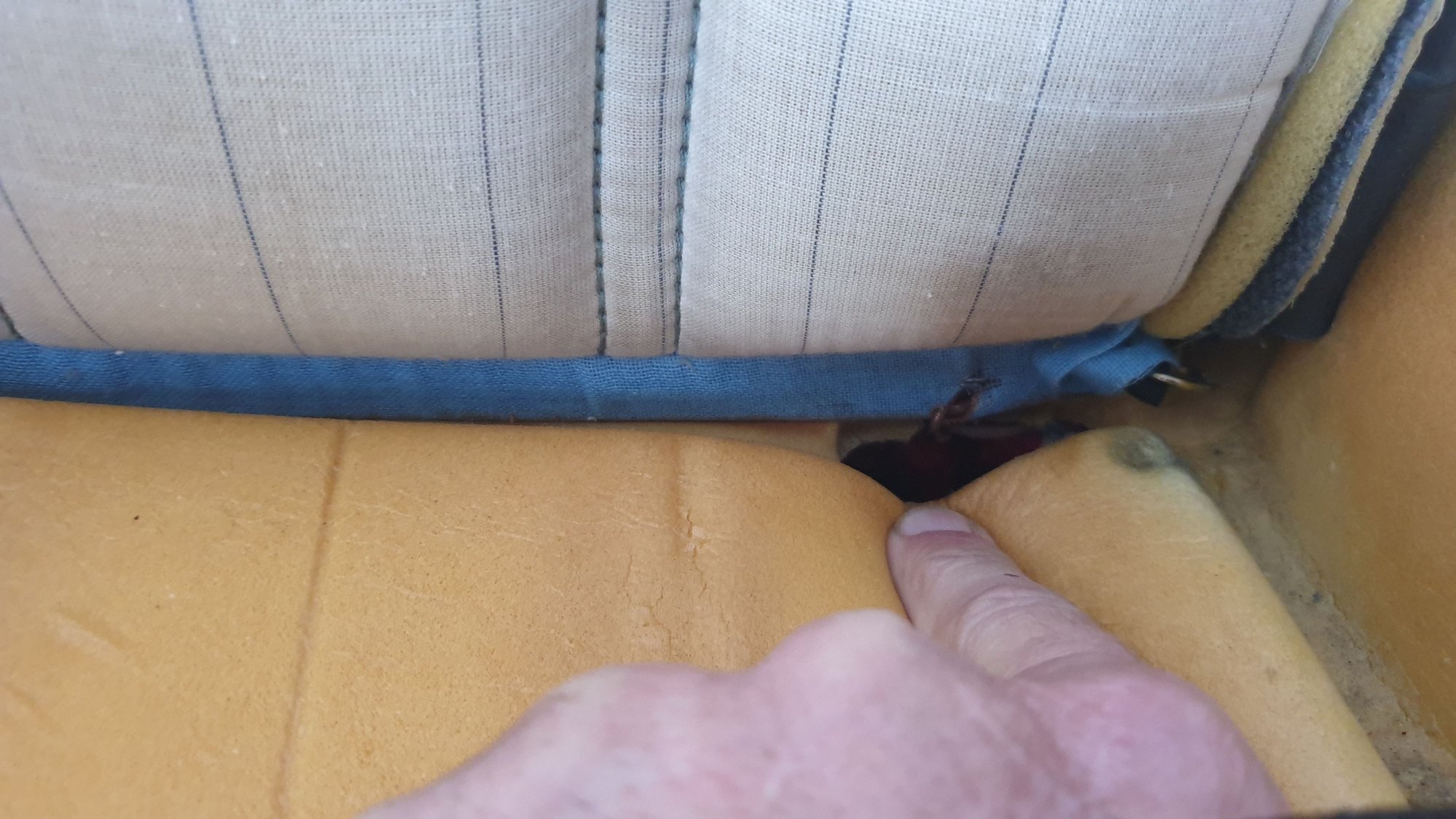

One pic more for reference:

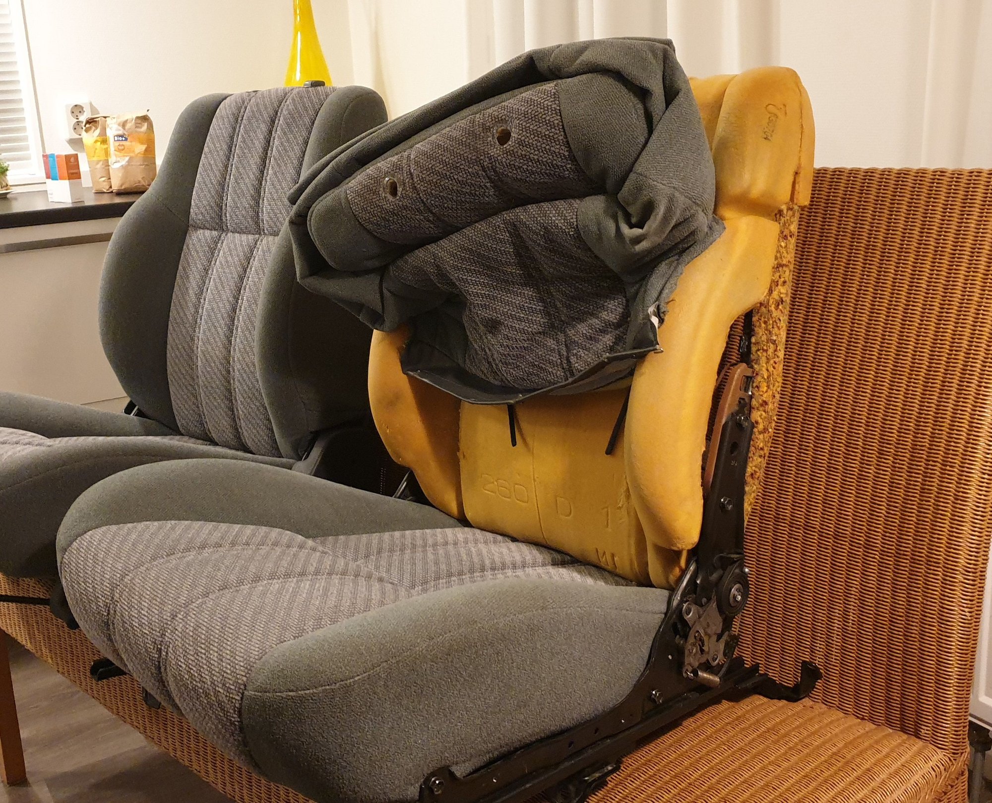

Interesting:

What did the most damage to the foam on the bolsters to their bottom and back was the fairly beefy bar that’s part of the frame that helps keep the foam raised. It pretty much just wore through the foam on the underside.
i cut out out bad sections, then replaced with fairly dense cell upholstery foam. I then shaped it to look pretty much like the original. On the underside of the foam there’s the slot where that bar I mentioned slides in to keep the foam elevated. I took sections of vinyl material and lined the slot with it to lessen the impact of the bar and spread the load over a bigger area. So far it’s been working ok on the bottom, but the side bolster on the seat back isn’t faring as well.

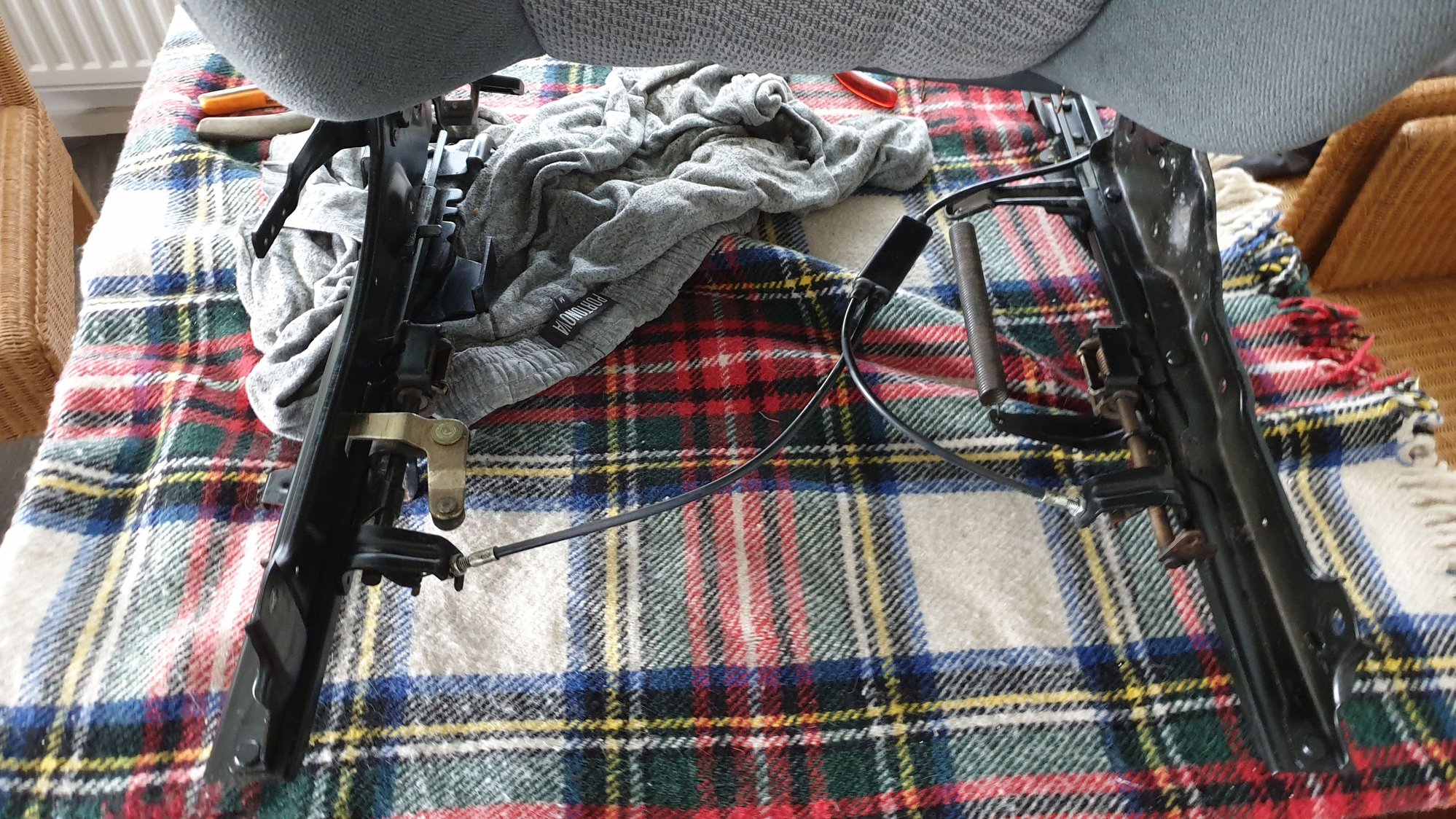

It is very easy. I did it with the front seats of my wife's 4Runner. I believe I made a thread about it, but I am not sure. You will need some upholstery metal rings and the pliers. That is all. Post photos when you start with it, we could guide you.
Edit:
I uploaded the photos in this same thread, this is the post:
https://www.yotatech.com/forums/f116.../#post52446765
