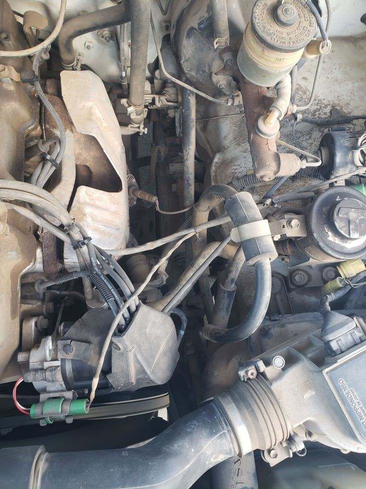

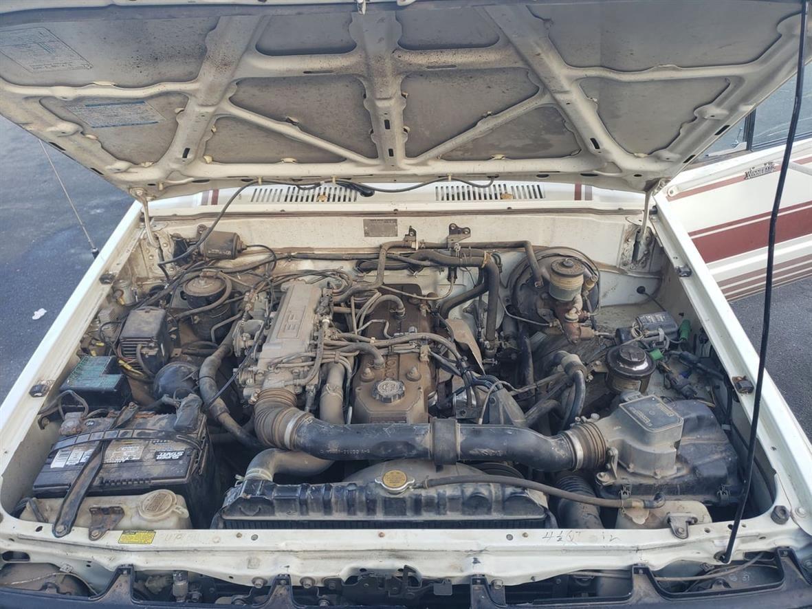

I own a 1987 Toyota Itasca RV that runs a 22RE engine. The steering is so tough that I am getting a shoulder workout every time I drive it. I am unsure if the power steering is just not strong enough or if the additional weight added to the chassis by the RV home is causing the wheels to be more "weighed down" or what but I need to find a way to either increase the strength of the power steering or beef it up with an upgrade.
Is there any way to increase the strength or sensitivity of the power steering? either through modification or upgrading? Is there an aftermarket kit for increasing power steering?
Any and all help will be appreciated.
