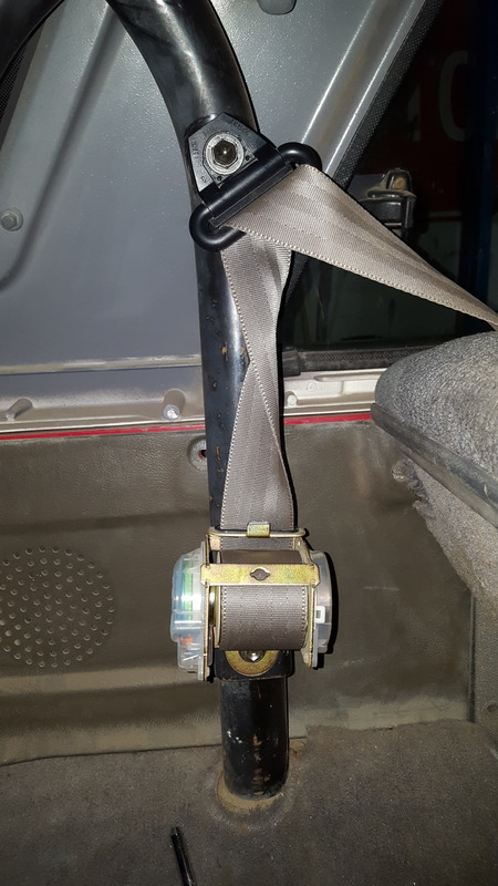

Thanks to this thread I just put belts from the back seat of a 3rd gen 4runner into my 87. Not the best swap but it works.
I might be able to put a few washers behind the top mount so it doesn't need to be twisted like that. Works fine as is tho.

Likes: 681
Fits better than mine.
I used a bushing and a longer screw on mine.

Ok I put 2 washers on there and it enables you to run it normal. Only spent $20 at the junkyard.
