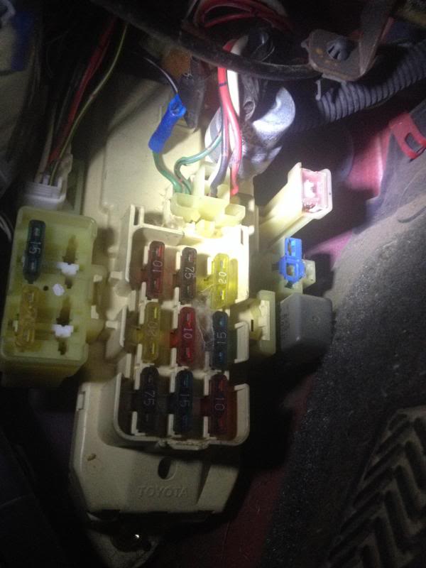

Ive had this truck for about 15 years, lol and never worried about the windows and door locks not working. I searched the web yesterday and when I discovered my fuse box, mine doesnt look like the drawings. According to the drawings I am missing the 30 amp power fuse/relay. Or am I? My driver side windows and door locks do not work. But, on the passenger side you can lock the truck from that button. I did find the blue/white wire had been cut at sometime going into the fuse box and splice back together. Im thinking they didnt do it right and thats why the driver side door lock is not working. Can yall look at my photo and see if I am in fact missing a fuse. Thanks in advance.

Update, I found a generic power relay at advance auto, plugged it in where the blue is above, and nothing. Still in the same boat, windows wont move. I am going to try and resplice the the door locks blue/white wire and see if that does anything......about to yank it all out and buy manual parts and convert to a manual windows.

Which drawing would that be? http://personal.utulsa.edu/~nathan-b.../2powersou.pdf (this drawing if for a '93)
You have an electrical problem, you need to trace your wiring with a multimeter. Replacing parts (or splices) at random is never a good idea, but you're just moving backwards until you isolate where your problem is.

I was using the first drawing. In the drawing where the #14 is, I didnt have one. So I put one in. Didnt help. The only splice I want to do, is where someone else did a bad job of splicing the blue/white wire which is suppose to be the driver side door locks. I have 3 used door relays that I found in the glove box when I bought the truck. I have tried them all, and no luck. I guess some time tomorrow, I will try using my ohm meter on the switches. Any other ideas? Thanks!

I can't tell from your photo, but it looks like you have the 30A fuse, and the place you plugged in the relay is just a blank (no connection).
The power to the door locks and window is through R10 on a W-R wire, probably the one circled.
The connection on R10 where your spliced wire seems to go is, so far as I can tell, to the starter relay. Probably once an immobilizer, but I can't explain why it's spliced to a different colored wire.
Yes, tracing through the door switches is where I would start; they are subject to being pounded on, and they are relatively easy to get to. If voltage is going through the switches, my next stop would be to take the door apart. https://www.yotatech.com/forums/f116...t-work-254772/

Thanks, I will try and get a better photo tomorrow. Guess I will also take the relay back to Advance Auto, lol. Thanks for all the help.
