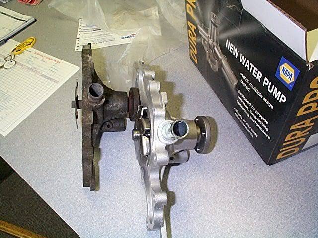

Check your water pump. The fan blades might have rusted away and it's not circulating good until you get the rpm's up which makes the fan spin faster.
Not a bad suggestion.
If anyone has allowed the coolant to get old and nasty or you have bad grounds you could have had an electrolysis problem that has partially eaten up the water pumps impeller blades and is now hurting the flow of coolant.
Electrolysis usually hits aluminum the hardest and the impeller blades are likely steel. If it's got really high mileage that can contribute
Testing for electrolysis is incredibly easy but is often overlooked.
Testing information can be found at
http://www.sancarlosradiator.com/Vol...ectrolysis.htm

that video does show signs of elecrolysis, but does not tell you how it is happening. (this is a huge issue with large engines with broken or missing radiator grounds) basically, the electrolysis itself can't be measured with a multimeter as it leis in the realm of electrostatic and ionic measurements.... but i'll put it in a way easy to understand: the airflow draws electrons from the radiator to land on the engine and builds up a static bias on the metal of the engine. the only way to return the electrons to the radiator is through the coolant, so it does so, breaking down the metal in the process. much like rubbing your socks on carpet to build a bias and then touching something with fewer electrons. you get shocked. think of the block as you. this measurement is measuring the continuity of the coolant as basically a conductor breakdown in the form of content in the coolant.... so basically, electrons are pulled from the radiator to the engine, then flow back through the coolant. good new coolant takes high voltage to do this, but as more metal is broken off in the coolant it gets easier and increases coolant and elctrolysis. when you find this condition, you should properly ground the radiator to prevent it from occuring. i've seen the difference first hand, where the same engine in the same vehicle has had the newer one ravaged by elecrolysis sometimes unusable 2x where the older one is uneffected because the radiator is grounded, in 30k cat engines. electrons flow from the radiator to the engine and need to get back to the radiator somehow.

Hmm, the electrolysis idea is one that had not occurred to me. Recently my one-year-old battery would not start the vehicle - everything went absolutely dead at the same time. Turns out that the negative terminal had a fair amount of corrosion built up, so once I cleaned it off, everything was like new again.
How would I rig a ground for the radiator? Would it be as simple as running a 10-gauge wire from one of the radiator bolts over to the battery ground on the fender?

on the original radiator, the shroud or mount bolts would work fine for a ground. either battery, body, engine, or frame, if your grounds are attached, it will reach the engine. on the aluminum, make sure it's metal contact that reaches the radiator coolant, many can have plastic tanks that wouldn't do any good to ground there.
