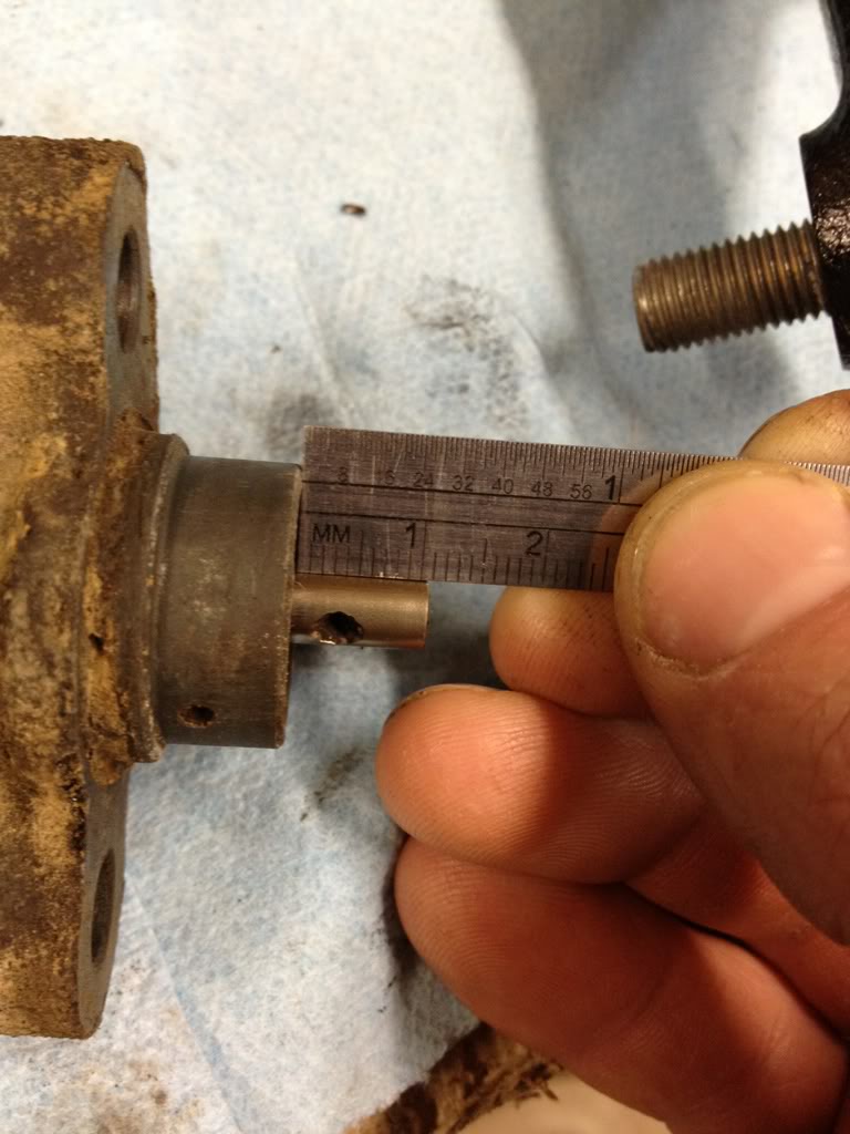

I have a question too. If my tensioner appears to be good except the shaft is maybe a touch too far out of the housing. The spec is 10 - 10.5 mm and mine might be 10.75 mm. Would you put a new one in?

I would purchase a new tensioner, the piece of mind is well worth the price, trust me on this because you only want to do this once...

Thanks for the input. I might go the piece of mind route and spend the extra money. I pushed down on it on a concrete floor and it didn't move a bit though.
