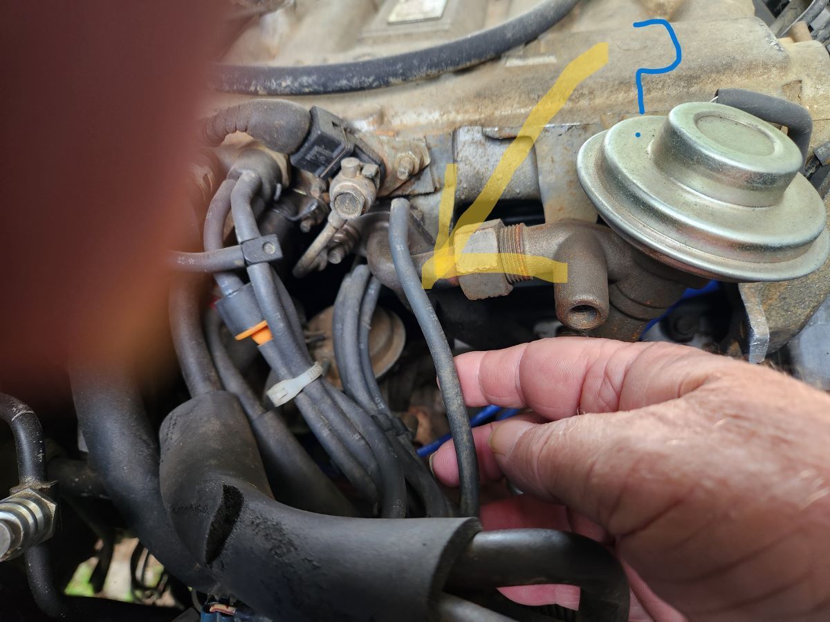

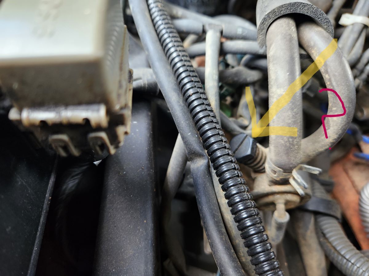

Hello, need help.......duh......I wanted to check and charge the A/C and I can not seem able to find the low side port. Of course while I was looking I came across two things I need help identifying. One pic will show a black plastic slotted cap. It has a huge spring underneath. Arrow pointing to it. Can someone tell me what that is? Next picture is me holding what appears to be a vacuum line that goes to nowhere..........Much appreciation in advance if anyone is able to educate me on this. Thanks.............and yes I'm still searching for the low pressure port on the A/C......I'm sure it's buried in there somewhere.

Does that vacuum line go to the egr valve? I think I see it buried under there and there should be port on the top it would connect to. There should also be a sticker on the hood with a vacuum diagram.
Old Jul 26, 2024 | 12:21 PM
49eryota's Avatar
Joined: Jan 2013
Posts: 24
From: SF Bay Area
In your photo looks like the port is directly behind the white zip tie bundling up some of the vacuum lines
Old Jul 26, 2024 | 12:23 PM
49eryota's Avatar
Joined: Jan 2013
Posts: 24
From: SF Bay Area
my bad that's not the egr by the way.

The slotted spring loaded black thing is the A/C idle up adjustment screw. It's gives the engine a little RPM boost when the A/C kicks on so it doesn't bog down at idle.

Thanks for that info. I looked through the shop manual and couldn't find it at all. In my search for the low pressure A/C port I unscrewed it thinking it was a cap for something. Of course it's not. It's got a long stem that screws back into the housing. I screwed it back together but I have no clue where it should be adjusted. Is it something I can turn the A/C on and adjust with my ear? Or is there a more scientific way to adjust it properly? Thanks again.........

Like Robert m said ,it is the A/C idle up valve. It adjusts your idle speed when the A/C is turned on. So at idle turn on your A/C and adjust it using your tach if you have one or by ear if you have to. Without it, your engine will lug down at idle with the A/C on.

The diaphragm behind the white zip tie is the PAIR valve. http://web.archive.org/web/201311071...78pulsedse.pdf If your vacuum lines are factory, and your loose line is labelled "#4" (it looks like it), then they go together.

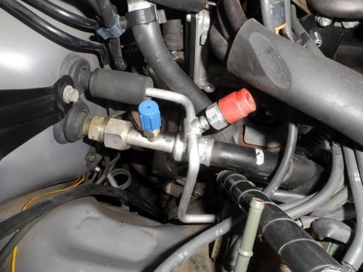

On my truck the low-side port is right next to the high-side port at the firewall.
If you don't have a low-side port there, the next place I'd look is on top of the compressor.

I wish mine was that easy to see and get to. I did find it. It was hiding behind the black tubing in the pic. Thanks for your help.
Thanks for that. Yes, my truck has a tach. When I started the A/C the tach actually went up 200 RPM.......Guess I need to adjust the screw to back it down a bit? Thanks again....
