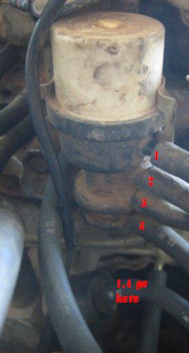

I also have a 4-nipple VCV, which seems to only match Federal/Canada diagrams. The literature itself references the VCV once, but for Land Cruisers only, not trucks (and the picture is not the one I have). I've attached a photo: #1 and #4 connections seem to go (according to some diagrams) to the nipple below, while #3 goes to the ASV. The #2 has a vacuum line going off into space in all my diagrams, any idea where this one leads? Also, the diagrams which show 1,4 attaching to that nipple also show a 3rd connection leading off to EGR land. It seems to imply that thing below (do we have a name for it?) has three nipples arranged vertically, instead of the single nipple I have.

The modulator should have three ports on it. I am thinking that someone may have mixed some parts from different years or models. You might need to go to a junkyard and get the correct one. Do not forget to hook up the hose on the bottom of the modulator along with the three on the top.
My FSM has a VCV in the vacuum diagram. Hose 2 appears to go to the air cleaner housing and 3 goes to the ASV. 1 and 4 both go to the manifold, so they appear to be in the correct place. 4 should have a VTV on the line between the VCV and the manifold.
A VCV is only for federal smog. California uses a feedback computer to control smog. There should be a vacuum diagram on your hood where it says the tune-up specifications that might help. An incorrect EGR modulator would probably cause your truck to not pass a CO test when under load.
