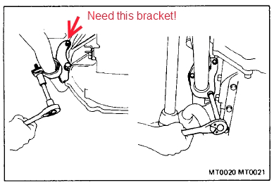

Originally Posted by scope103
Do you have the gaskets in place? P/N 90917-06038 , less than $4 each at the dealer.
You should replace the nuts no matter what. While technically not "one-time-use," since 1992 they've probably loosened up.
There is also a bracket that holds the intermediate pipe..
https://www.yotatech.com/forums/atta...st_bracket.gif
