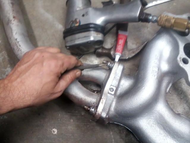

Here is how I fix my manifold and pipe problems. I torque the bolts on tight, use red locktite and then stake the nuts to the studs with a hammer and punch.
