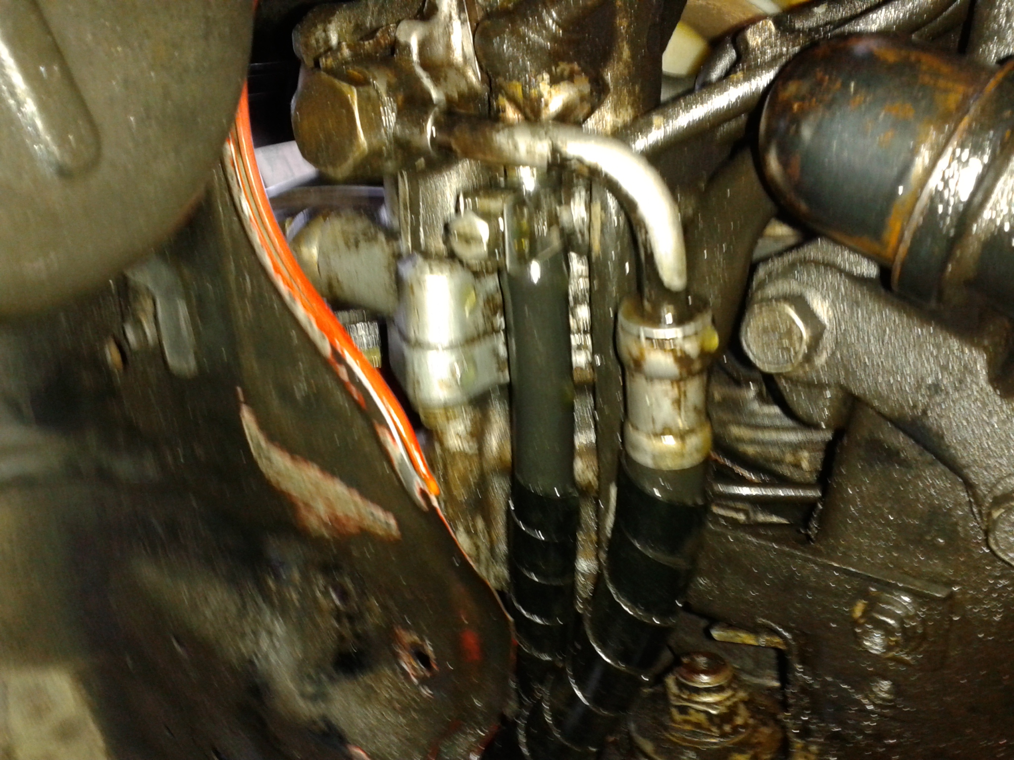

I replaced power steering pump now unit below I dont Know what it is is leaking from top power steering filud all over ,does any one know what it is ?1991 4 runner v6 manual trans 3.0-20141129_155818.jpg

The unit in your pictures is the ABS actuator. http://personal.utulsa.edu/~nathan-b...13generald.pdf
But you can't possibly tell if it is leaking in the state in which you photographed it. Fluid is all over the place -- even on the battery tray!
Clean it up first; for this, soap and water (garden hose) will work fine. Then start it, run it for 15 seconds, stop and look carefully for leaks.
Gravity is not your friend; if anything above the actuator leaks (PS pump, hoses, etc.) it will soak the actuator.

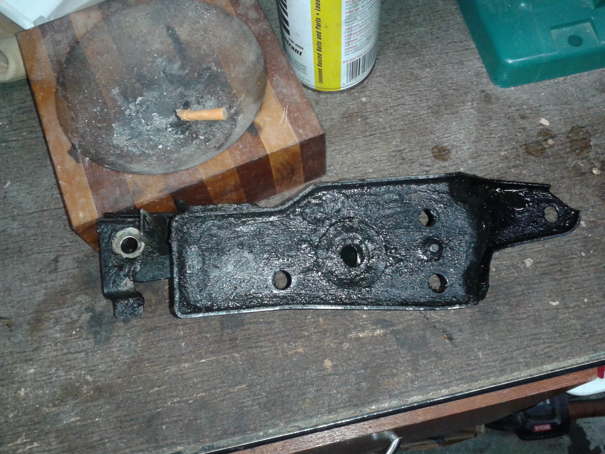

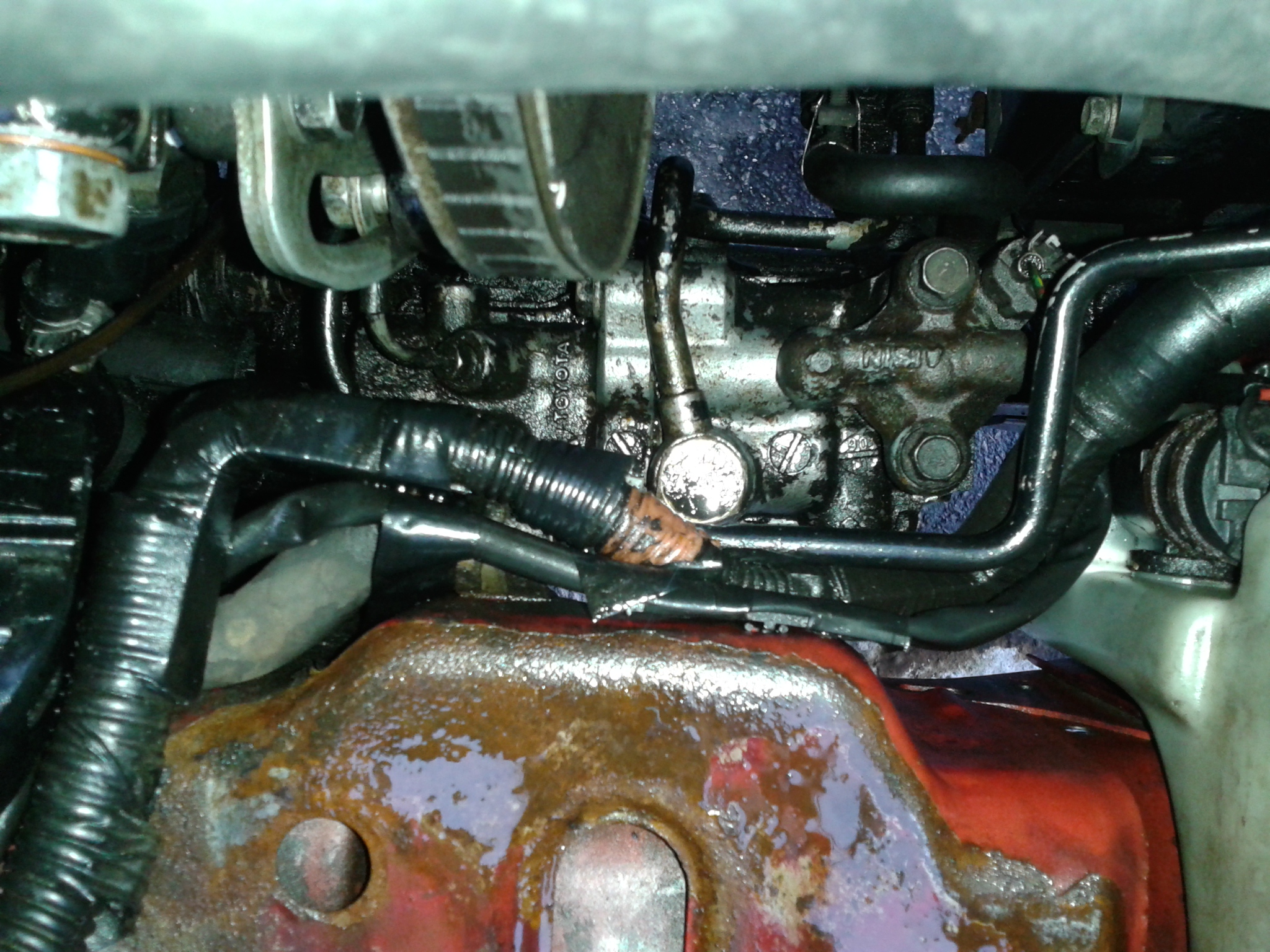

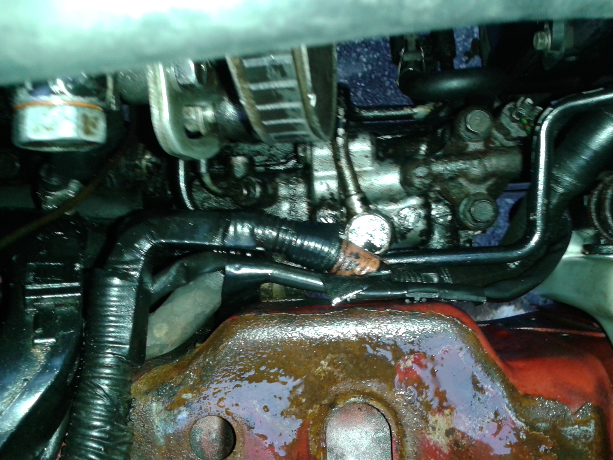

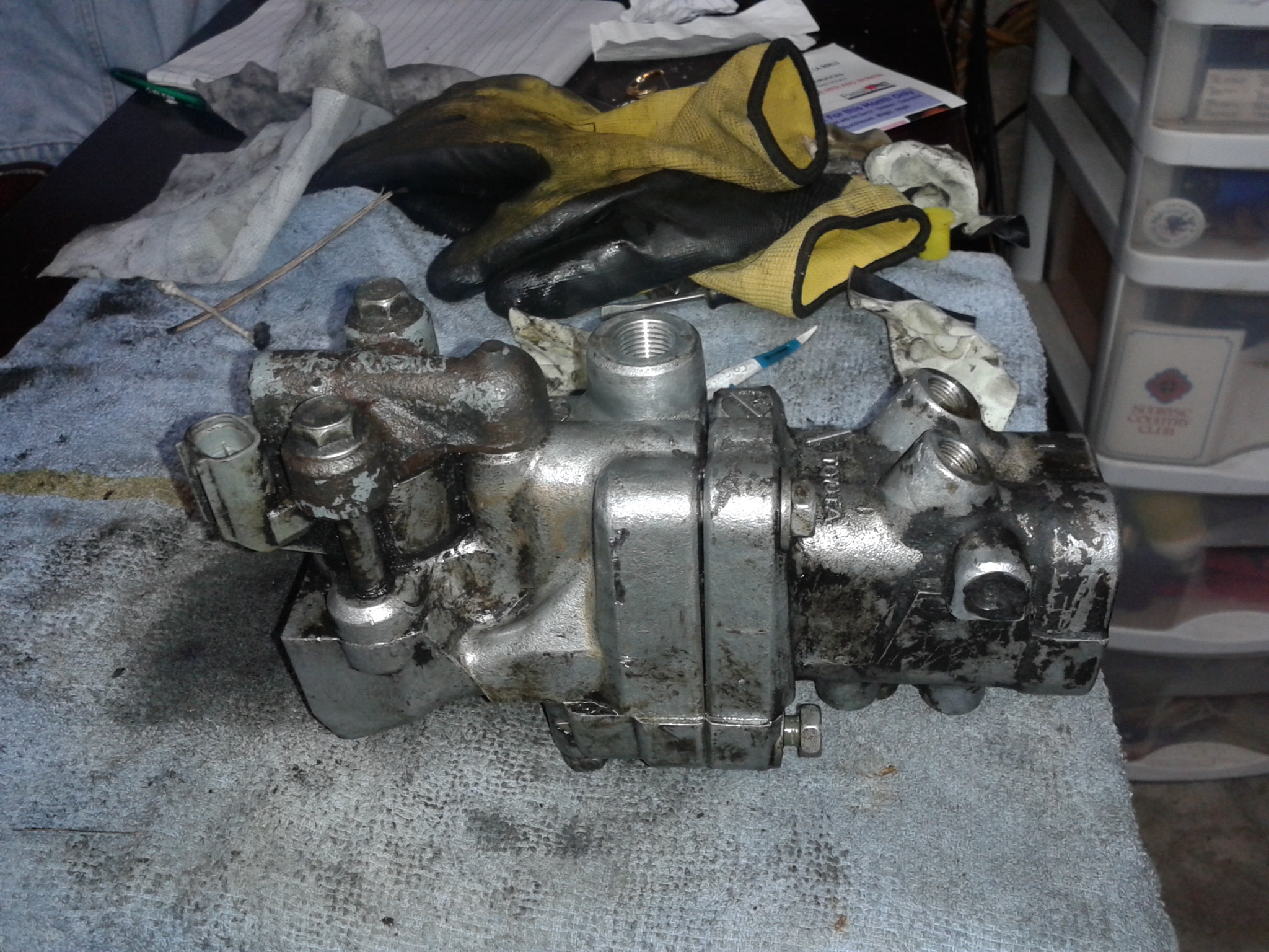

I finally got the break accuatior off here are pics
Attached Thumbnails 1991 4 runner v6 manual trans 3.0-20141208_180456.jpg   1991 4 runner v6 manual trans 3.0-20141208_180741.jpg   1991 4 runner v6 manual trans 3.0-20141208_181050.jpg

now I just need to find out what kind of gasket I need to use
