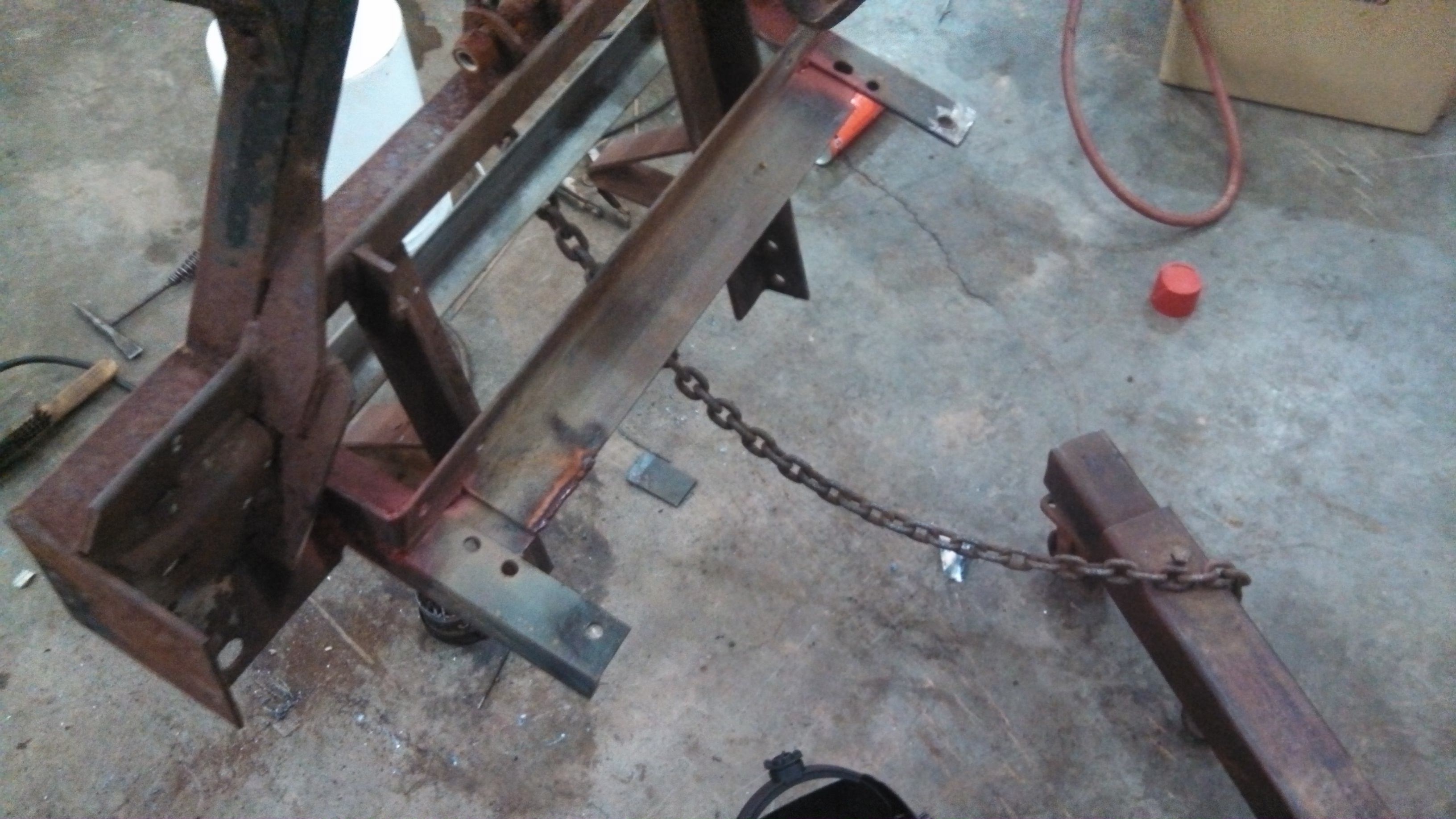

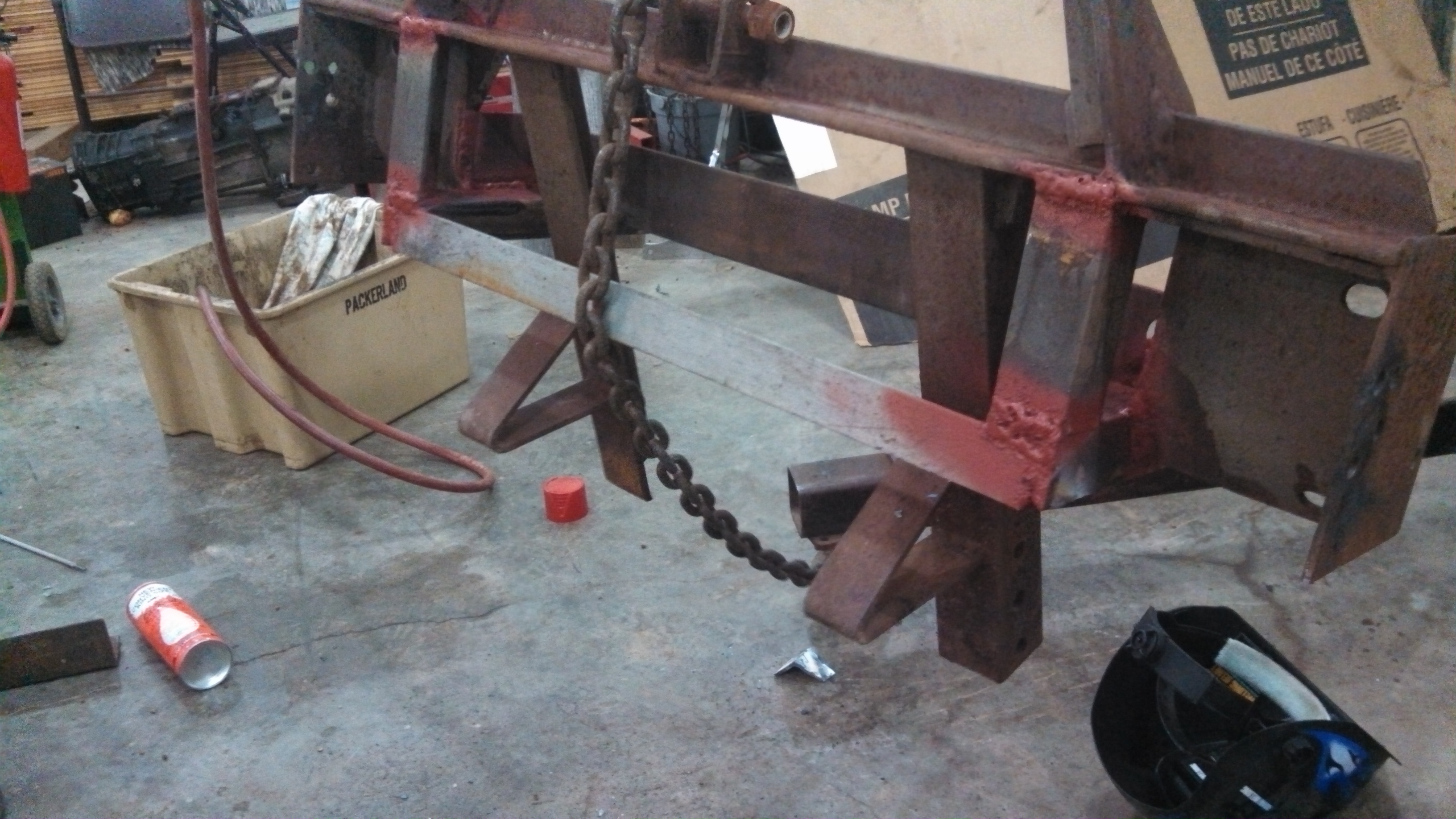

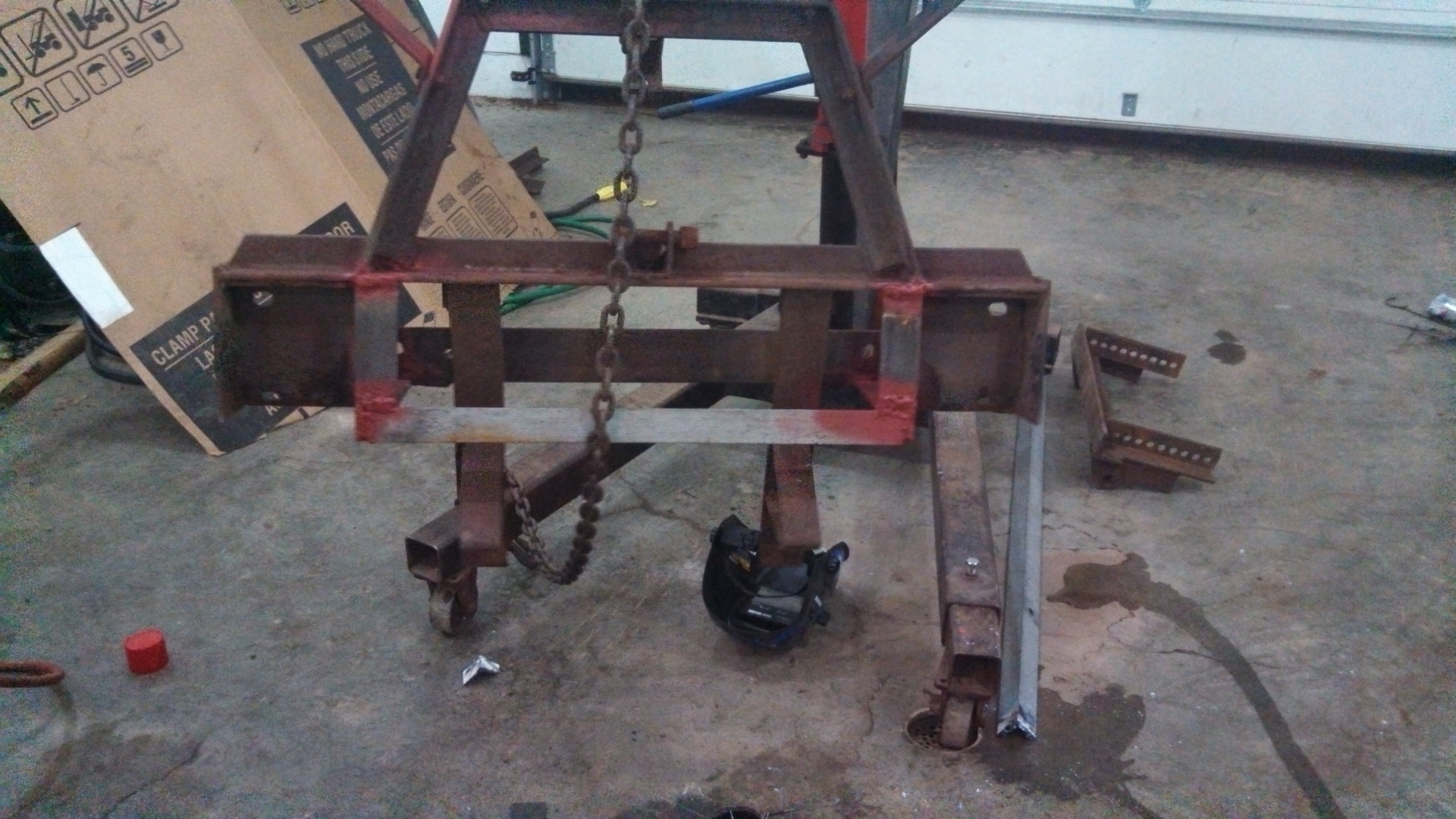

Also the plow mount is made out of 3/8 and 1/4 steel angle iron. Bolted in 8 spots with 12mm bolts and 2 spots with 10mm bolts.

Here's some pics Of the homemade mount. Almost done

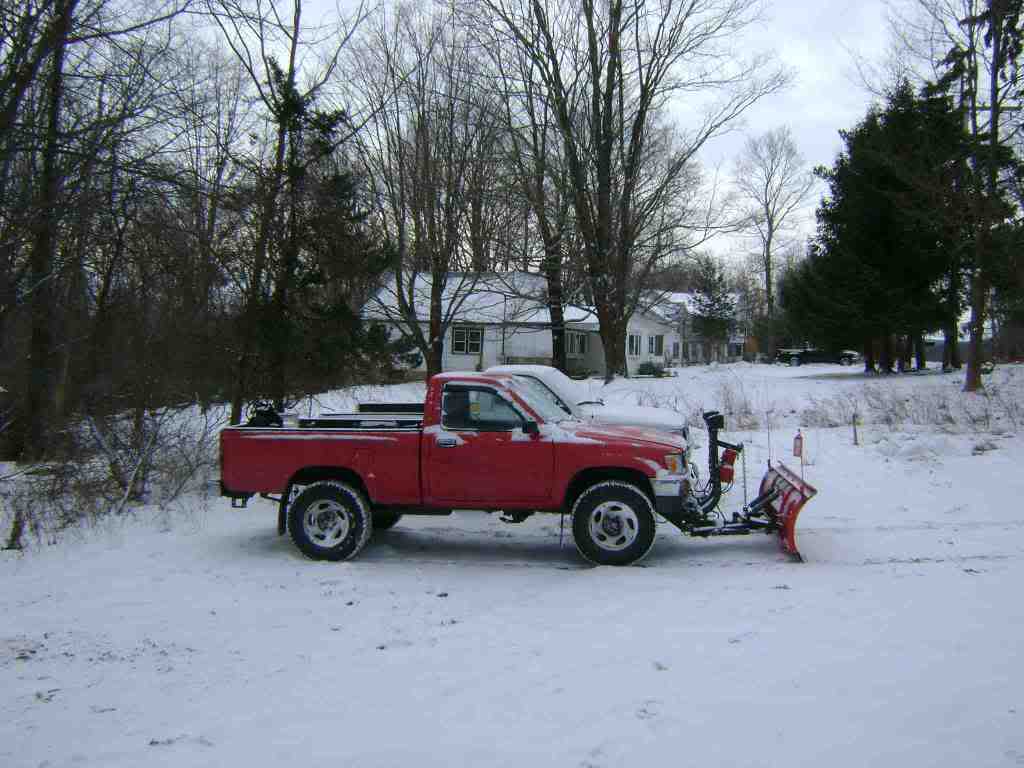

Plowed for 8 years with Toyota trucks, same 6.5 Western with unimount.
Yes upgrade Alt 100amp plenty, ballast in the back 400lb [use salt bags in plastic tubs/5 gallon buckets comes in handy if you need traction. Secure them in place so they are not banging around the bed] crank the torsion bars and add a leaf in the back.
Will send you a pick of my Unimount tomorrow.

Each tool has its niche, and Toyotas are great for driveways.

Old Nov 1, 2013 | 09:01 AM
milkybar's Avatar
Joined: Jan 2013
Posts: 57
Attached with two bolts underneath and two in front each side, frame has all necessary nuts factory welded in place.
