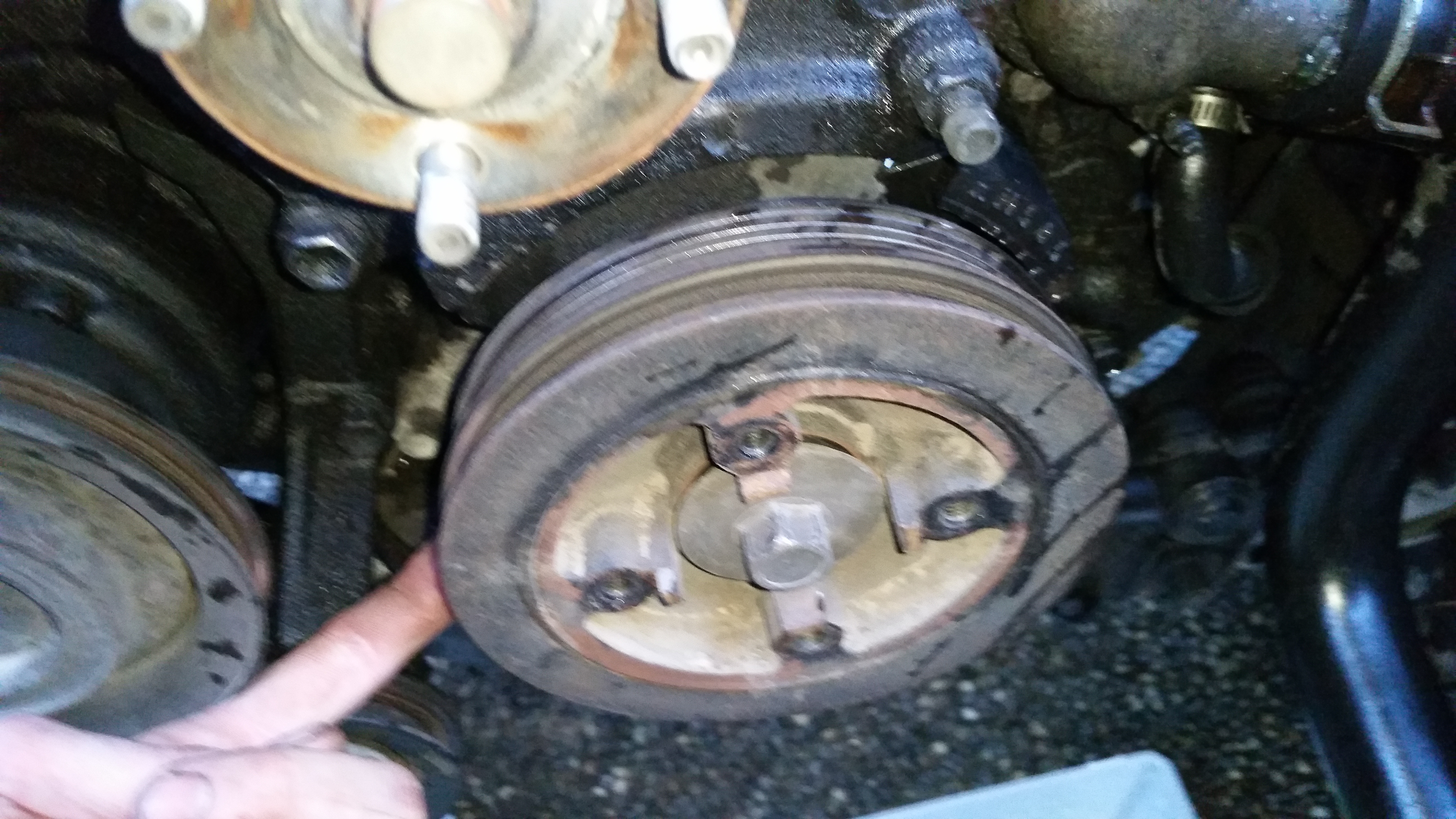

So I believe I have found the root of my problem. But what could cause the crank to jump 180° out?

Why do you think its 180 out?

Is that suppose to be a loaded question?
It's an old timing belt. From what I see and input from a mechanic with 30 years experience, the crank spun through the timing belt.
