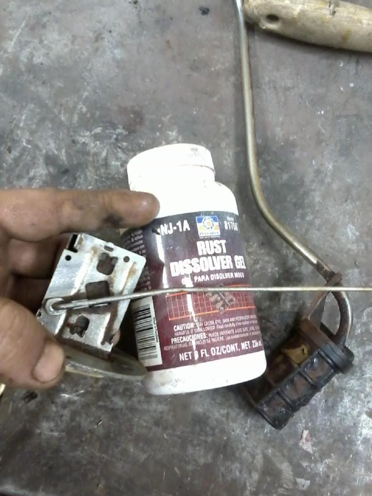

The fuel tanks can get nasty in them. There is a sock/filter on the end of the fuel pump that can get a crust around the sock and not let fuel in. That is my suspicion.
The filter below is for a 22r truck but I have seen 22re's just as bad. It gets a coating around the filter. This one had just a small area to where the fuel could enter. I am wondering if your pump is getting just enough fuel into the sock to let it pressurize the system but not enough to keep it running.
