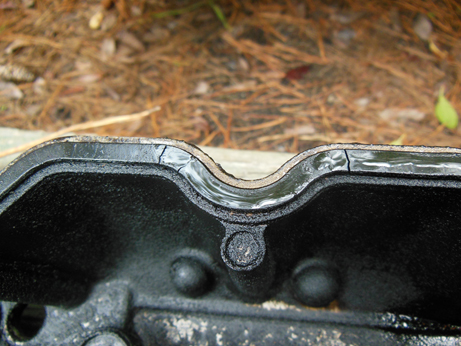

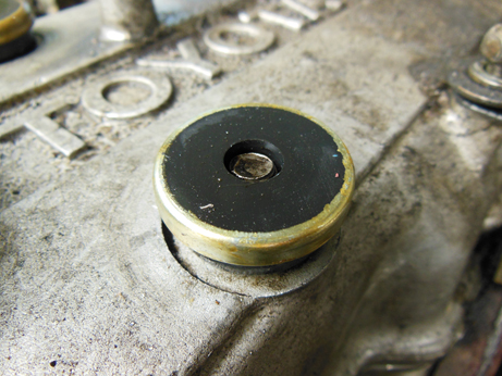

The VC grommets from the 1989 kit are too tall. I had to order the early type grommets (pre-1984, I think).

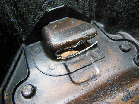

The timing chain has worn through the oil baffle on the VC. (Cover is the later, squared-off style).

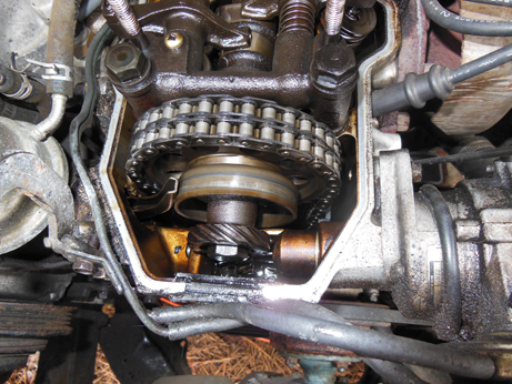

The timing chain is double-row. (pre-1983, I think, unless an unlikely conversion)
The block is stamped "22R" below the first freeze plug and has the TEQ logo cast into it below the last freeze plug (pre-1985, I think). The early block (and head, I assume) must have been swapped in by a previous owner. For now, my plan is to delete the oil baffle, bolt the VC back, and see how the truck runs. Longer-term, I'm not sure how to approach things like timing chain and guide replacement. I assume most parts I'm currently running will be early types, but it seems like a real can of worms.
The late VC should fit on the early head, right? Is there a better explanation for the damage to the VC oil baffle?

you got a first gen 22r in there! Someone swapped it.

Well it happens .
All you need to do is get the timing chain kit for a 83 .
If your interested I might have the correct valve cover and a new timing chain kit .

More searching around leads me to think the only issue with running a later, squared valve cover on an early (1981-82, double-row timing chain) 22r is that the double chain won't clear the oil baffle.

another way you can check, is 81-82 was dual row timing chain, 83 and 84 were single row. all 4 years had round exhaust ports, in 85 they went to a pear shaped exhaust port and different deck height, you can look at the difference in first gen 22r and second gen 22r timing chain covers, the earlier 81-84 had a straight section that was curved in the 85-95 water pumps. another way is to check the block. on the 81-84 blocks there is no "mickey mouse" behind the drivers side motor mount. 85-95 had 3 circles that resemble mickey mouses head. this was for the oil return line for the turbo on the 22ret. they used the same block, so on the 85-95 block, the outline is there but not cut. hope this helps!

I’m piecing together an engine i picked up that is a laser block with an itm head on it. I bought a valve cover off of eBay that is supposed to be for the later model years (it is squared off) but when I went to bolt it on, the studs barely stuck up past the grommets. The grommets that I have do not fit inside the head and should sit on top of it with the stud sticking through.
Any ideas? I gotta get this thing finished and am considering a long bolt I can thread through.
