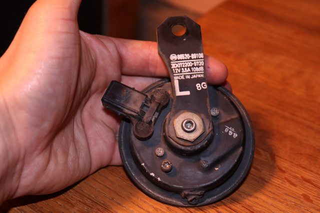

I'm pretty sure I narrowed my horn issue down to the actual horn being the issue. I checked the horn itself and I can't get it to make any sound with a 12 volt. I figure that I should just replace it and call it a day but I'm having trouble finding the right horn. If I type in the part number I can only find one ebay ad for a used horn which is a little bit expensive.
As far as I can read the part number is:
86520-89106
Here is my actual horn:
I'd much prefer the original horn as the truck is all stock but if that isn't possible maybe I will opt for an after market one. What horn do you guys recommend that is plug and play? Also the ebay ad I see is here:
https://www.ebay.com/itm/86-87-88-89...AAAOSwOzxe-5IC
Any idea what "8G" is as opposed to "8H" ? Also there appears to be some kind of elbow sticking out of the bottom, and mine does not have that. Other than that both horns look to be the same.

When I go to a wrecking yard I could grab one for you, but I've been waiting awhile for a 4Runner to drop at a yard close to me. If I can get one it should be pretty inexpensive. lmk
Yours had the "elbow" but is now gone. It was to let water drain out. Your clearance lights in the corner had tubes to let condensation out, also.
The "8H/8G" could be production runs, or even city location of Denso factory. I don't know. If the 10 digit Toyota part number is the same, or a superseded one, than you're good to go.86520-89109 would interchange with yours.

The horns themselves were all pretty similar. It wasn't uncommon to see basically the same part on a Corolla, Celica, or Van from the same time period. In this case, the bracket that mounts the horn would often be the only difference. but that you can take off your old one and swap out.
If you get a horn off a different model Toyota I'd recommend taking the connector off the wiring harness, too, just in case. If the connector is slightly different than your existing one you can take the terminals out of your old one and slide them into the connector you got with the horn. A tad more work than splicing, but a lot cleaner. Once you get good at taking wires out of terminals it's actually faster than splicing.
