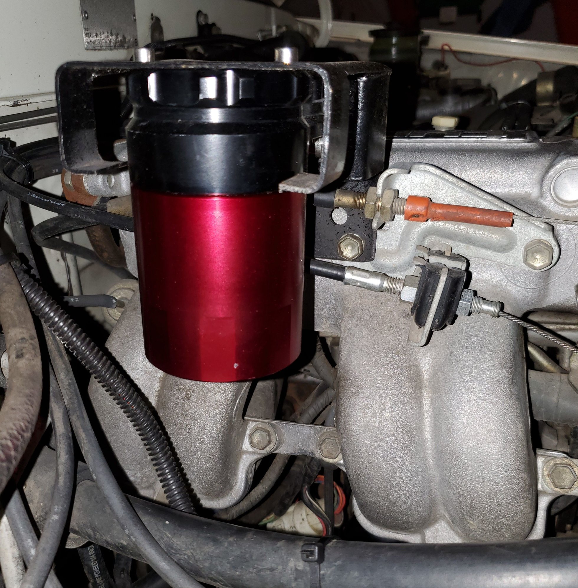

I improvised on the install and made my own bracket..

No need for a check valve the PCV acts as one.... run the line from the valve cover to the filtered side of the CC then run the outlet line to the plenum.
simple, inexpensive, and functional.

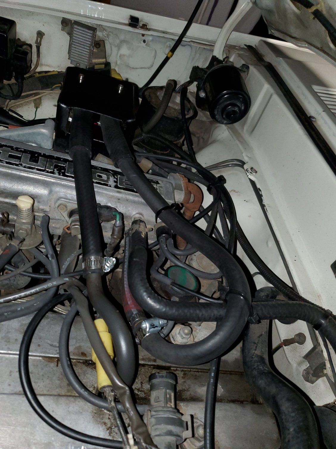

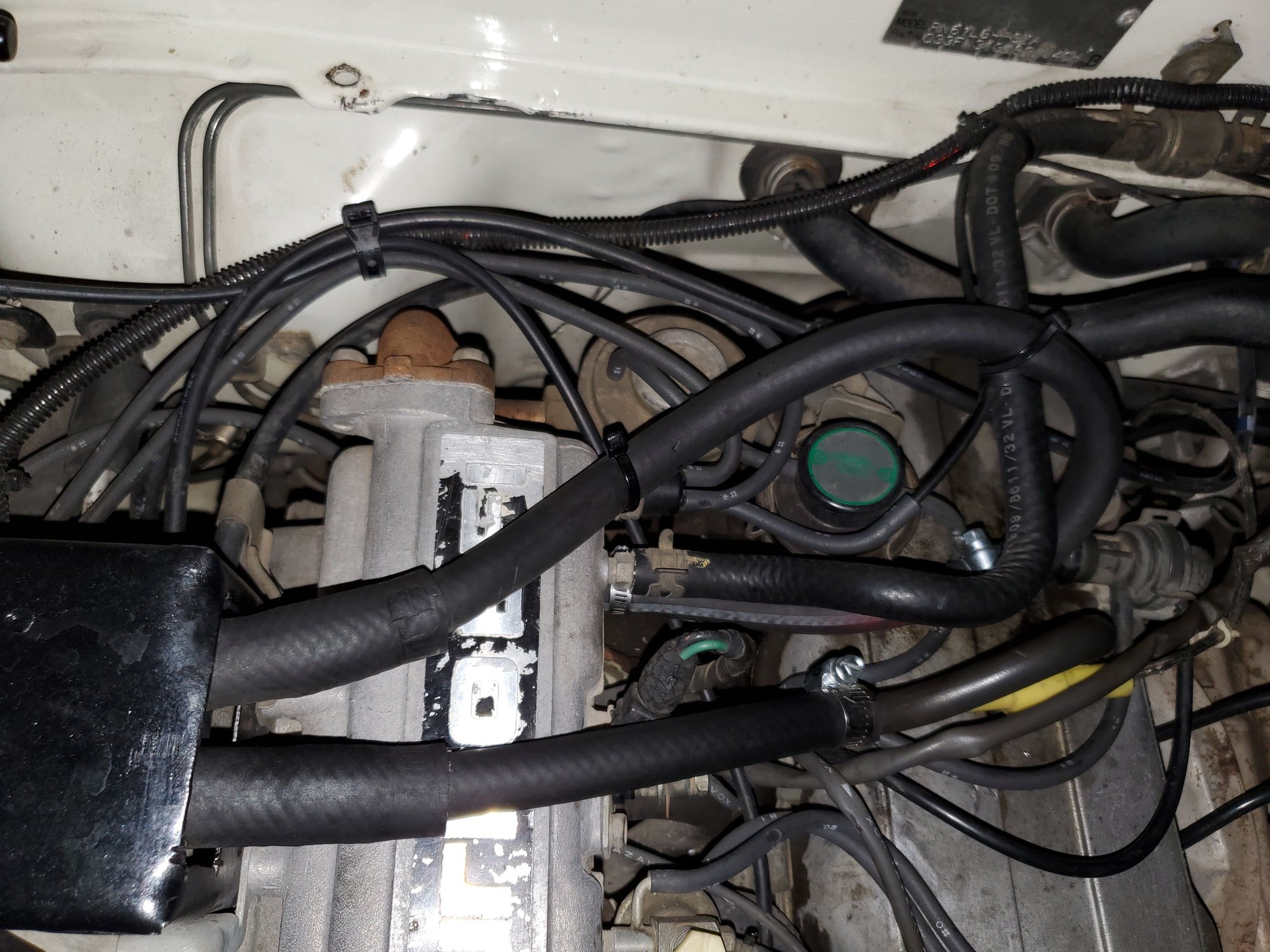

Old Jan 1, 2021 | 05:36 PM
87-4runner's Avatar
Joined: Mar 2012
Posts: 1,139
Likes: 414
From: Oklahoma
Couple of pics of my install and what is in the catch can after about 100 miles.
it's cold and wet here in Oklahoma so extra condensation.
yes, that gunk would have been recycled thru my motor, and it is in yours without a CC.
