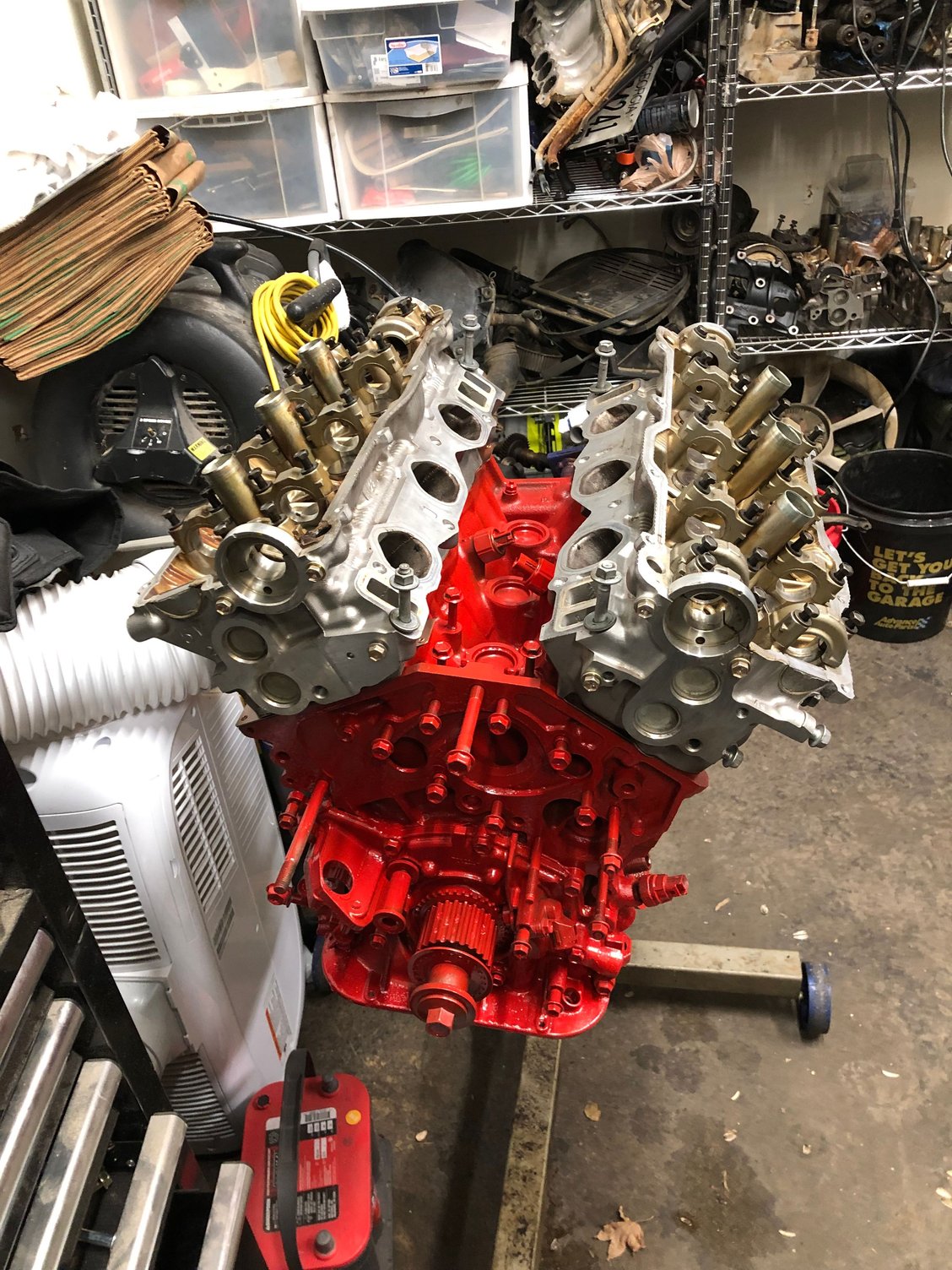

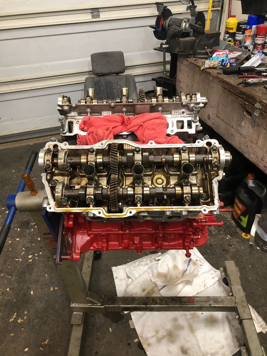

Old Feb 25, 2019 | 01:45 PM
charles.isbell85's Avatar
Joined: Aug 2016
Posts: 77
Got the 3.4 together

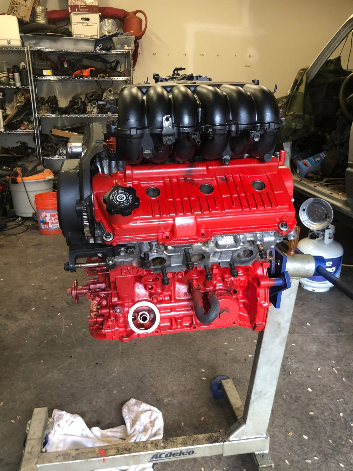

Old Feb 27, 2019 | 09:09 AM
Joined: Aug 2016
Posts: 77
Got the oil pan on.
Old oil dip stick hole plugged.
Old Feb 27, 2019 | 11:03 AM
Joined: Aug 2016
Posts: 77
QRS dip relocation kit worked great.

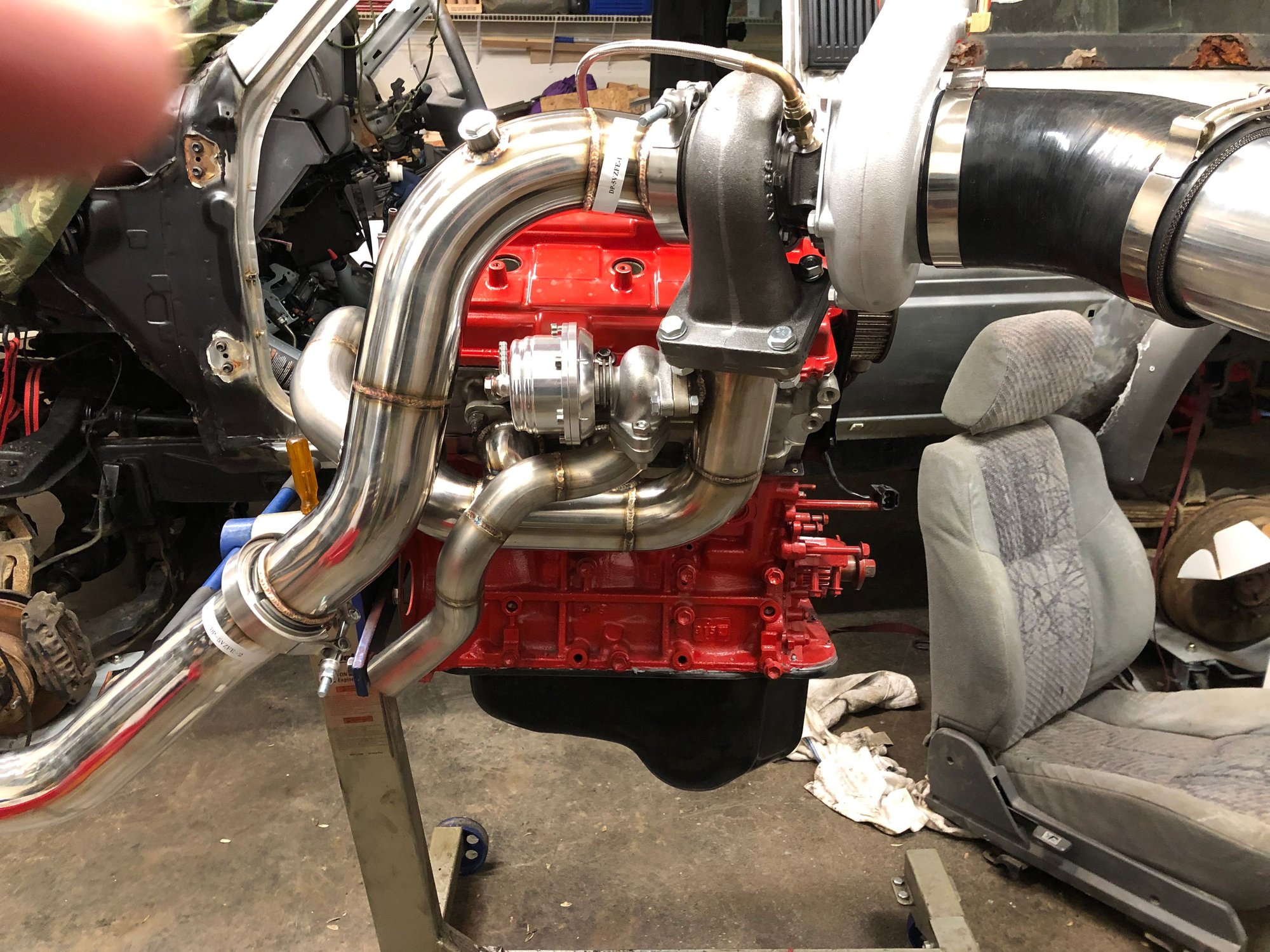

Old Mar 13, 2019 | 06:33 AM
Joined: Aug 2016
Posts: 77
Turbo kit mock up. Needs some refining but looks like it will go in with no major issues.
Old Mar 13, 2019 | 08:11 AM
Greedy's Avatar
Joined: Apr 2003
Posts: 495
From: Woodinville, WA
Did you make the drivers side mani or did that come with the kit?
Old Mar 13, 2019 | 08:15 AM
Joined: Aug 2016
Posts: 77
It came with the kit. It’s dumps on the passenger side. Going to try and make it work but I need to get the motor in the 4runner first and check clearance.
