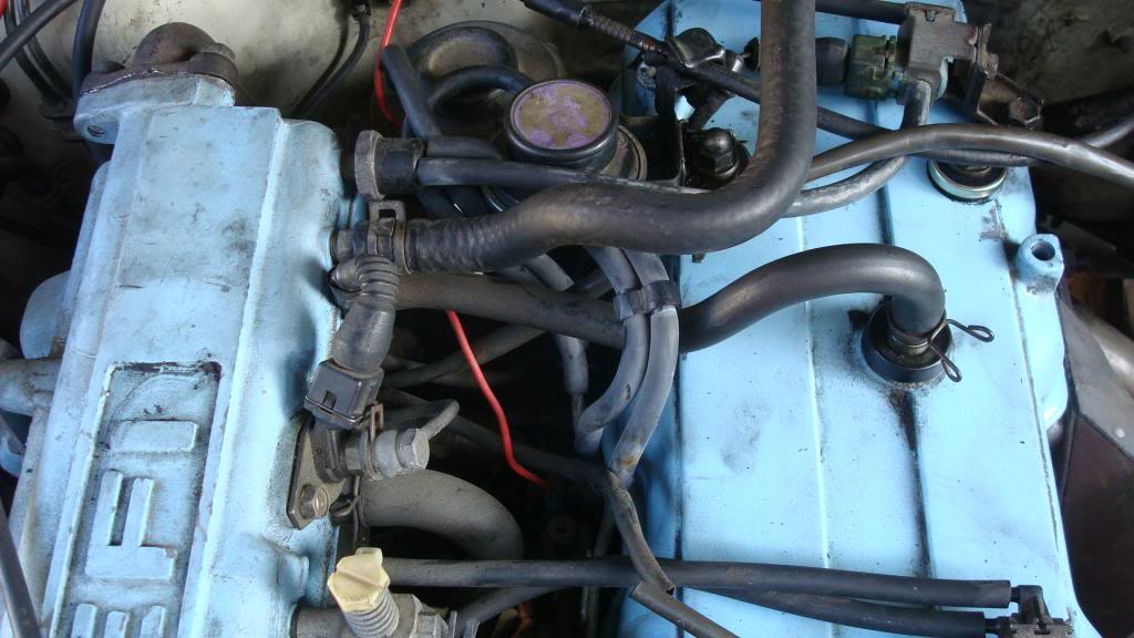

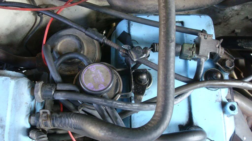

I found on top of the valve cover towards the rear there is a little box with a electronic connecter and theres a vacuum line from the intake going into the front, then on the back there looks like there should be 2 vacuum lines but one is broke off. Does anyone know what this, where the vacuum lines run to on the back, and if this could cause the problem? I dont see any vacuum lines not hooked up so not sure about it

First off the TPS has to be adjusted for the engine to operate properly, there is no way around it.
The rear VSV (Vacuum Switching Valve) on my 86 goes to the fuel pressure regulator.

Thats what i was talking about, looks likes yours only has one line coming out the back also, must not be the problem. But yes im gonna adjust it tomorrow night, just didnt have a multimeter to do it tonight when i stuck the sensor on

The front VSV on mine does have 2 hoses which you can just see in the bottom of the first pic.

Im talking about the one towards the rear of the valve cover. In the second pic you see one vac line coming out the rear

I got cha. The rear VSV should only have 1 hose on each side. Vacuum from the plenum and then on the rear it should go down to the fuel pressure regulator.
The VSV with 2 outlets and 1 inlet is for the AC Idle system. The front inlet is open to atmosphere and the rear go to the idle speed adjusting knob.
Possible yours are backwards?
The top one here is actually at the middle of the valve cover.
