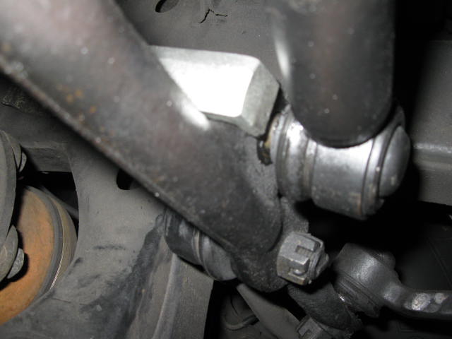

Hi Folks
Trying to remove 30 year old Steering Stabilizer. Having trouble getting driver side off. Do not want to damage it in case my new one does not install correctly.
Any ideas on how to remove driver's side. It looks like the bolt is pressed in. Have tried some pounding to no avail. Tough when your on your back.
Any help appreciated
Thanks
Jim

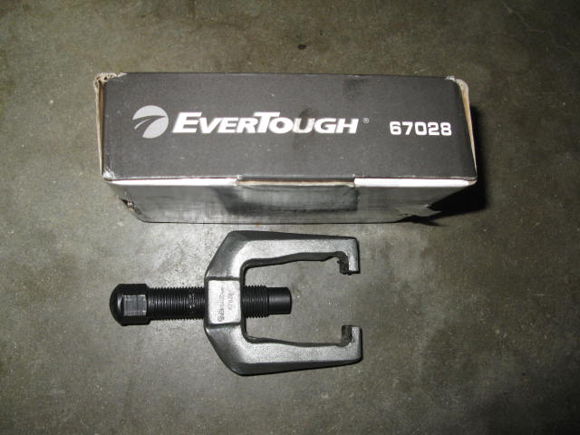

It's pressed in like a ball joint or tie rod. I rented one for about $12 from autozone. I ended up using a pitman arm puller because of the wierd angle. Comes off real easy and won't damage the threads.

Don't use a sledge hammer; as TransAmBandit pointed out, it will ruin the end of the stud and the damper can't be reused. More importantly, impact like that will probably ruin the hanger, too. Then where would you be?
Don't use a "pickle fork." http://www.minimania.com/part/660490...r-Mini--Cooper Nothing says "amateur" like that "tool."
Here's a pitman arm puller like bpealer referred to. http://www.harborfreight.com/tie-rod...ller-1752.html For $15.00 to buy, it's hard to justify renting one. Put it on, crank on it with a socket, bam! It will come right off without tearing the heck out of your rig.

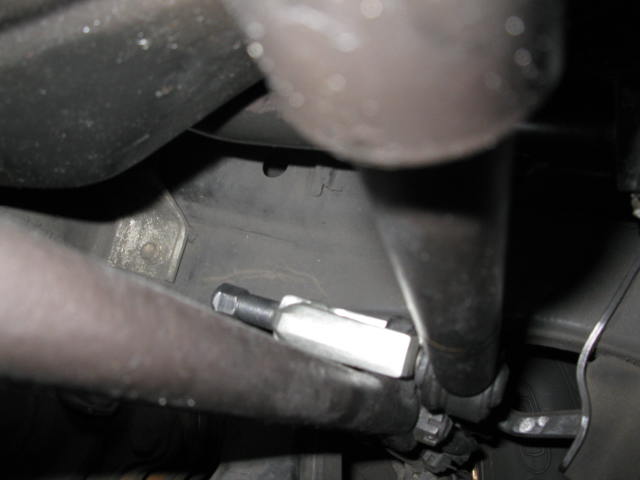

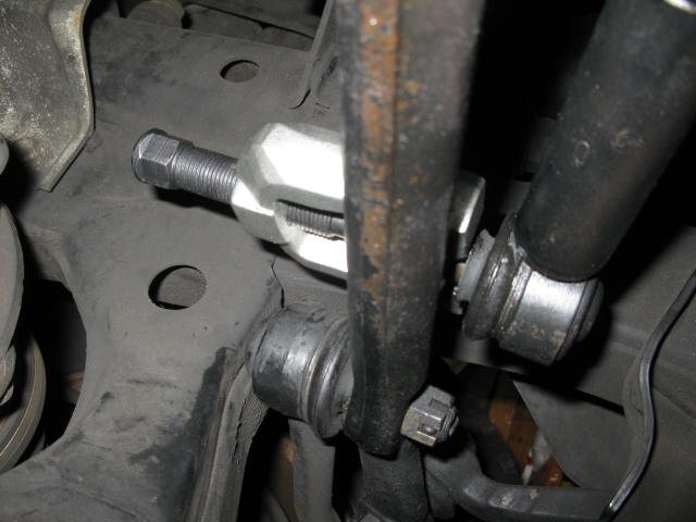

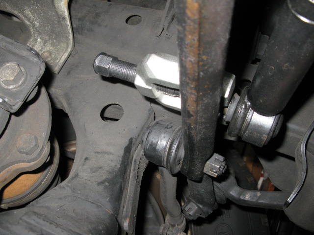

I understand the premise of the tool, but have never used one. I am looking at the pitman arm puller and my problem area and I don't see how that tool is suppose to fit on the stabilizer. Their is a nut on the back side that I can get off with the cotter pin. I am not sure how to position the puller so that it pulls the stabilizer away from the hole where the bolt goes into.
Old Jan 28, 2016 | 10:14 AM
scope103's Avatar
Joined: Sep 2007
Posts: 8,384
Likes: 875
From: San Francisco East Bay
C'mon, just google "Pitman Arm Puller."
Once you back off (DON'T remove) the nut, the center shaft of the puller PUSHES on the threaded stud (with the arms PULLING on the damper mount, not the damper).
You leave the nut on because (as you know) it's on there pretty tight, and when it lets go you want it to move 1/2" and stop. Not fly across the garage.
Old Jan 28, 2016 | 10:42 AM

Thanks scope103
sorry.....did not understand what to clamp it to
got it now

Just wanted to thank everyone for their advice and input. Got the old one out and the new one in on Saturday. Got a loaner pittman arm puller from Oreilly's. Did the trick.
Thanks Again
