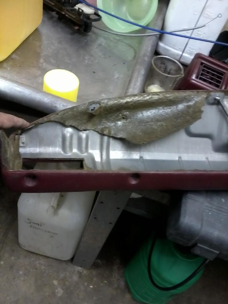

Duct that needs removed to get the center nut of dash pad. Once you remove it, straight up is the nut.
