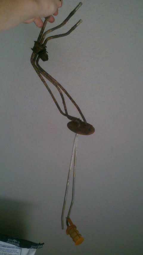

Anyone know, or tried to put one of these (http://www.jcwhitney.com/dorman-oe-r...c2070d2183u0j1) into the stock fuel tank with any success? My current fuel pickup has the lines completely rusted off it all the way to the top of it where its screwed into the tank, so i have nothing to connect to fuel lines to.
I'm having an extremely hard time finding the part number for a new one or finding one in a local junkyard. My tank is still good. looks new inside so i hate to scrap it. My truck has the mechanical fuel pump on a 22r motor if that makes a difference. Any information would be greatly appreciated. Thanks

Toyotapartseast has the part kinda pricey but they have the part for my 86 truck. part # 23206-35120 I just did mine

Dude Thanks a lot. Hey i got three lines coming out of my stock one though. One goes to my fuel filter. How does that work?

Also i noticed you have the electric fuel pump. Mine is a Manual. And i have a diferent tank. 77203-35260 thats the vin for the one im supposed to have

Sorry you didn't say that it was carbed maybe you can do what Ed did here >https://www.yotatech.com/forums/f199...l#post51919871

Yeah I just gotta find one of those. All the Junkyards around here dont have any of the Toyota pickups or 4runners. Im wondering if i should just try the universal one.. Here is a picture of the one i have now. The lines are shot
