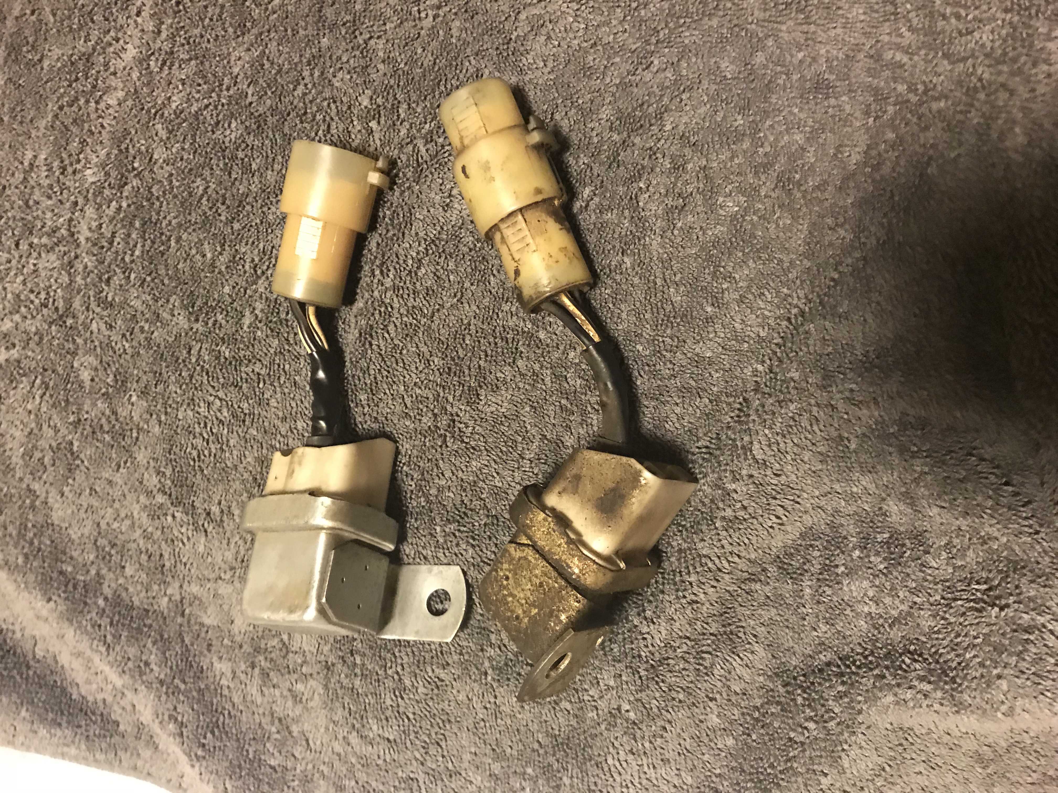

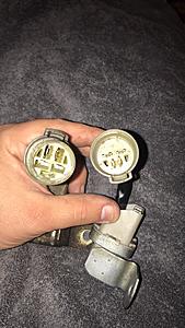

I recently purchased a male end starter relay off of a 1986 22r and when I went to put it on my 1986 22r, I realized the starter relay
on my truck was a female end. I was wondering how I can make the male end into a female end like my original starter relay ?
Attached Thumbnails 1986 22r Starter Relay difference-09df885a-5855-48e4-8751-3016f8797775.jpeg   1986 22r Starter Relay difference-0708b3b9-3fc5-4731-9594-aed14a36199d.jpeg

Take the pigtail/connector off the original and splice it on to the new one.
BUT, why are you doing this?
I doubt if your starter relay is defective. Pls see my signature. In the 6 years I've ben with Yotatech, I have never heard of a starter relay going bad on our trucks except for this
Are you aware of this? https://www.yotatech.com/forums/f199...l#post52297396

Just get enough spade connectors of the correct gender
Figure out if this is the problem if it is then do a somewhat better job of splicing and weather proofing

I found another female starter relay today, Thank God, so Ill test that one, if it doesnt work out Ill try the wiring solution.
