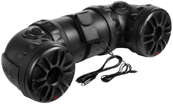

I honestly don't know how much current the speaker tube draws, its designed to be plugged into a cigarette lighter style outlet on an ATV so I don't think alternator work is necessary and that's why originally I wanted to have everything plugging into the same power strip. I could wire it directly to the battery and use a relay that's tripped by a wire to the power strip though if you guys think that's the safest way to do it.
The tube in question:

That doesn't look like more than 16 or 18 gauge wire on that power plug. My guess is the "700 watts" is mostly hype, as is true with so many audio products. Average power is probably less than 20 watts. I think you'll be just fine wiring to the ignition wiring. Put in a 10 amp fuse to protect against excessive current draws. If it blows, you'll need to beef up the wiring. If not, you're good to go.

I searched around and found this Q&A on the unit. Because of the intended application (ATV audio) along with the cigarette lighter power plug and the small wire gauge, I also think that it would be fine to run the multi-outlet setup in your first picture. If you wire this to your existing cigarette lighter power source, which in my '90 4Runner is a 12V, 16AWG line with a 15 Amp in line fuse (normal for most cars) you should be safe to power the speakers, GPS and phone charger.
As others have said, if you start blowing the 15A fuse you will have to install a separate ignition activated relay/wire setup.
