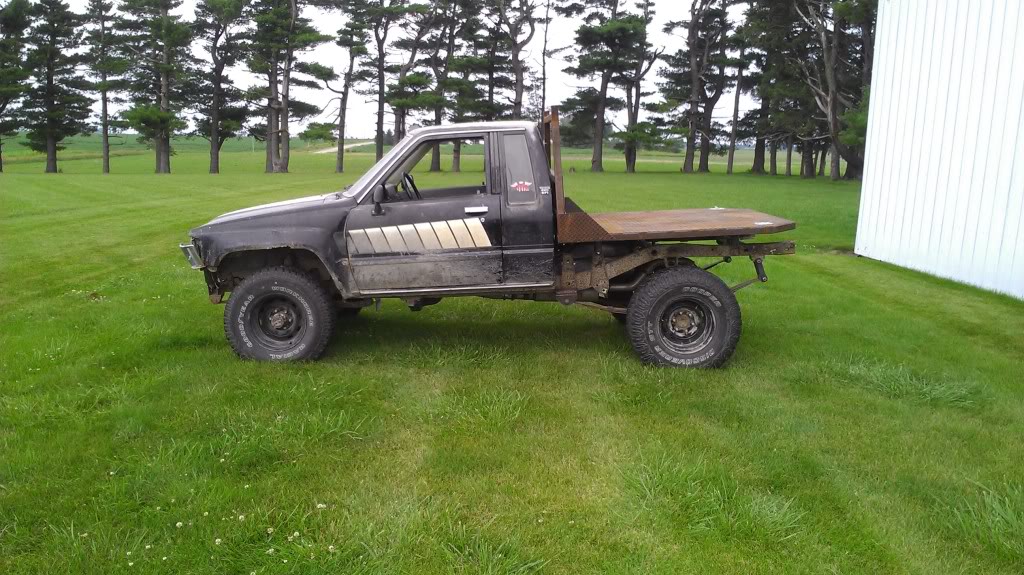

I've got 70's-80's factory Chevy rally wheels on mine, painted black. I had to plasma cut the center hole so they would fit over the front hubs. I personally think they look good and the back spacing is to my liking.
i dont have access to a plasma cutter, i was really hoping those would work though.. how well do they balance.. assuming you drive it on the roads.
They seem to balance out fine. I don't drive it on the road much at the moment tho. It's more of a project for now while I build it up the way I want.
